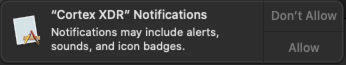

@bcbackes , @matin or anyone , do you know how to remove the notification so it won't be displayed after successful installation? I'm using newer version of Traps. I'm using Composer and Configuration Profile to Approve Kernel Extension
update : Fixed using https://github.com/Jamf-Custom-Profile-Schemas/jamf-manifests/blob/master/macOS%20Notifications%20(com.apple.notificationsettings).json , thanks @talkingmoose

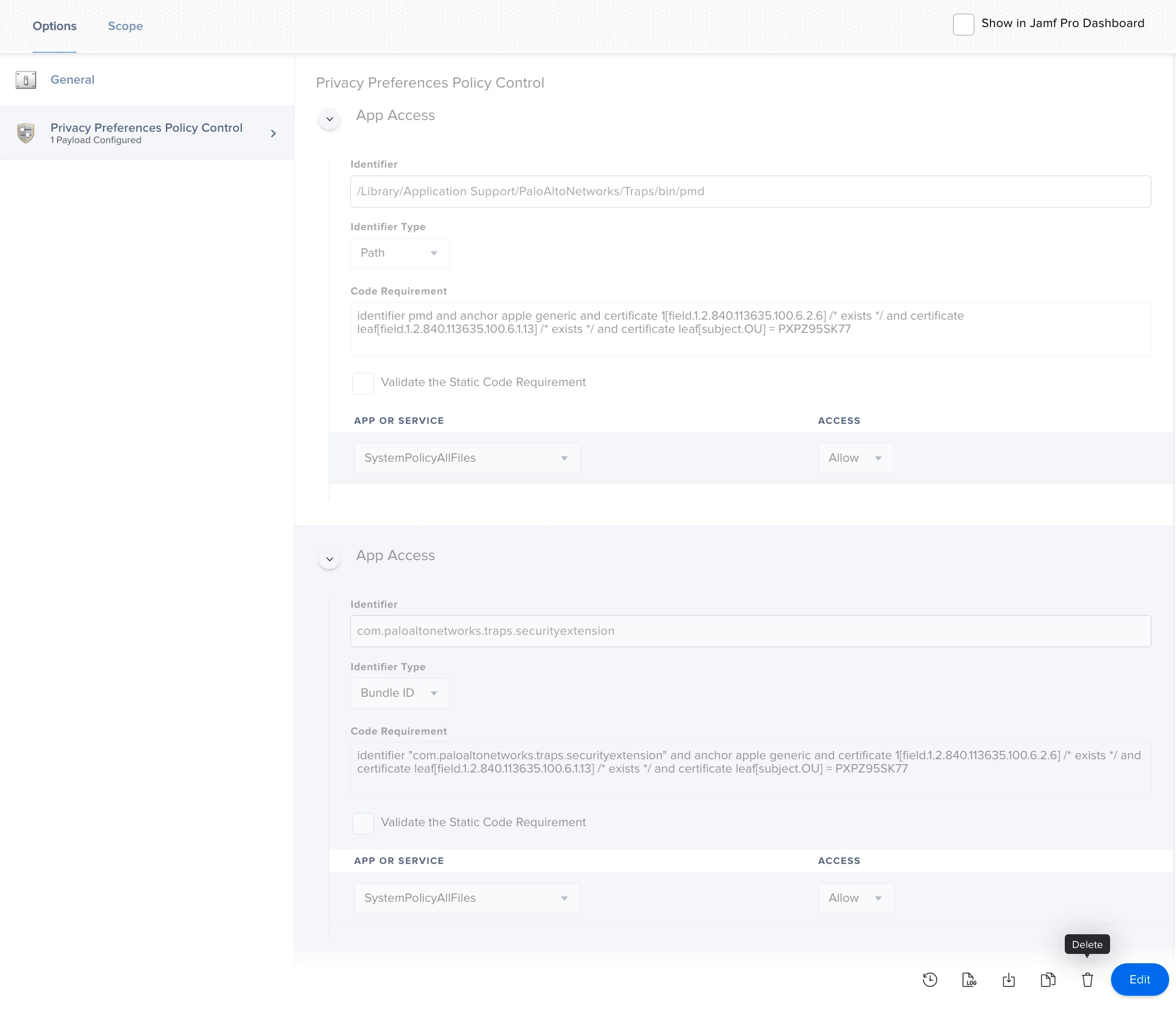

@udhayakumar on that page, select v7.1 for newer info, but some of it is incorrect. What macOS versions are you deploying to?
For macOS 10.15, the missing information is to add the following PPPC config profile:
Identifier:
com.paloaltonetworks.traps.securityextension
Identifier Type: BundleID
Code Requirement:
identifier "com.paloaltonetworks.traps.securityextension" and anchor apple generic and certificate 1[field.1.2.840.113635.100.6.2.6] /* exists */ and certificate leaf[field.1.2.840.113635.100.6.1.13] /* exists */ and certificate leaf[subject.OU] = PXPZ95SK77
App or Service: SystemPolicyAllFiles, Access: Allow

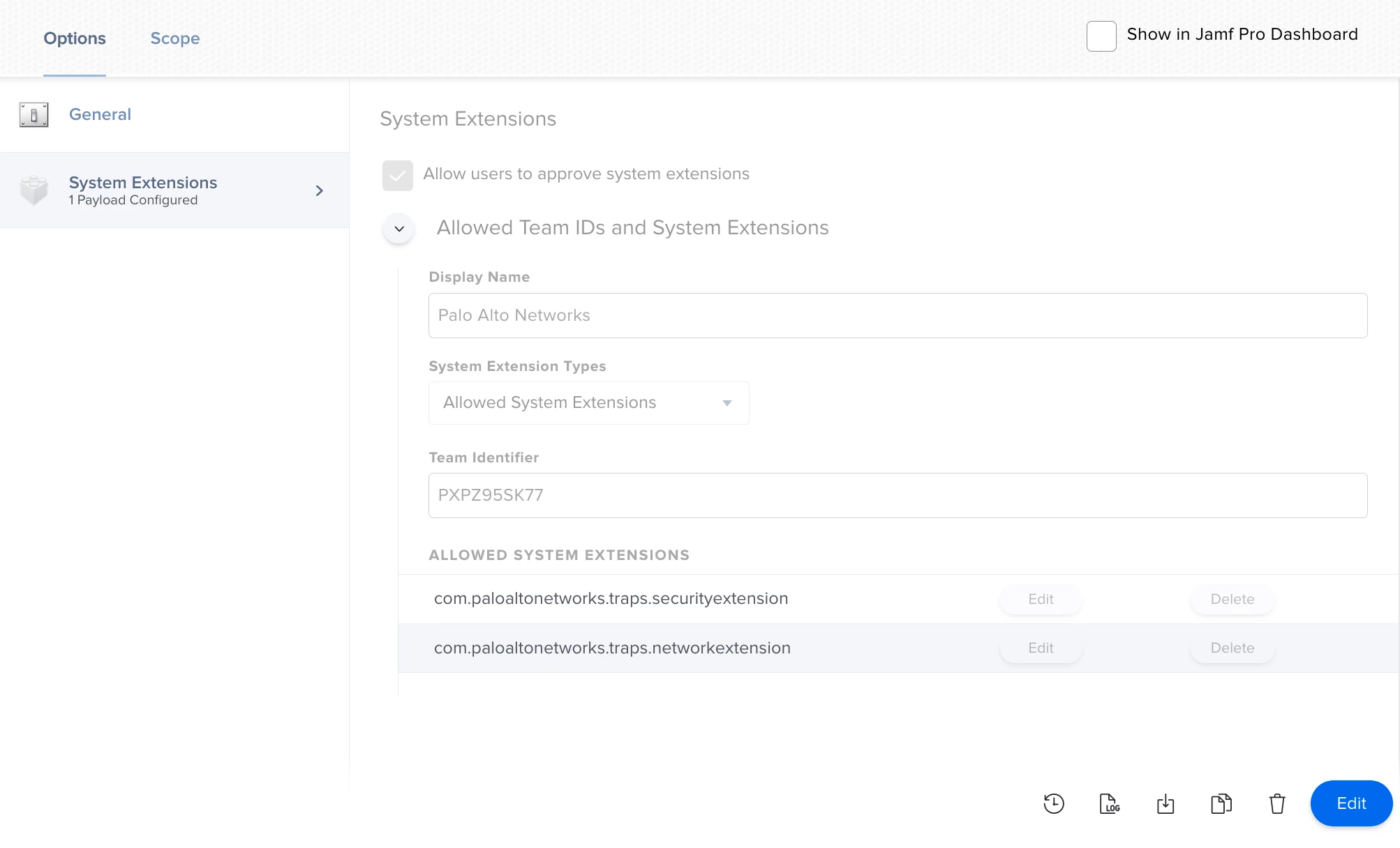

  1. Add the System Extension config profile. I would scope to machines that are running 10.15+ and UAMDM is Yes.
  2. Add the PPPC config profile. I would scope to machines that are running 10.15+ and UAMDM is Yes.
The setup for macOS 10.14 will be different so just keep that in mind Palo Alto haven't made it clear what those settings are, but I would use the information for 6.1.x or 7.0.x. Those settings should still work in addition to what i detailed above. Cortex may fix itself on macOS 10.15 if you've already deployed 7.1.0, I haven't tested that yet.

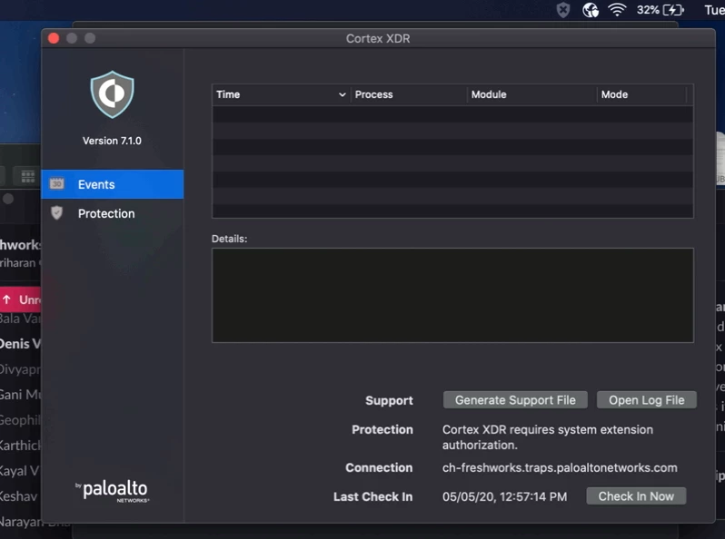

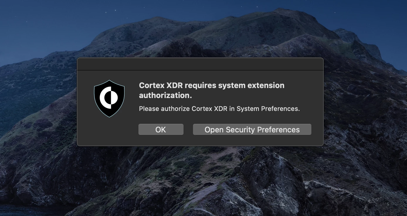

@davidhiggs today I have upgraded the latest version to all the Mac users, but most of the users getting the error to allow the application manually but I have added the team ID already but. why its asking the user to allow the application manually? can you guide me on this.
  • May 5, 2020

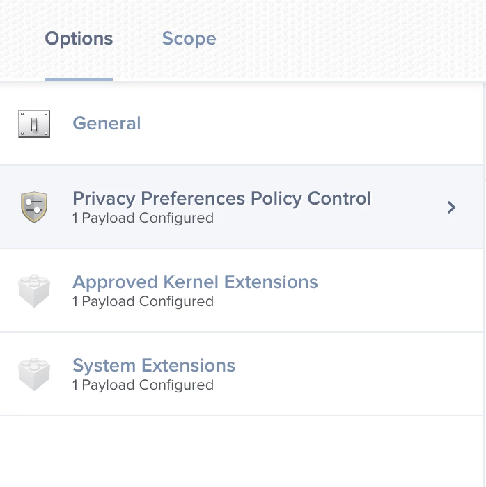

@udhayakumar You really need to follow that website carefully, and you should be ok. Here are notes I kept after discussions with Palo Alto and doing testing:
Kernel Extension Config Profile
macOS 10.14.6 - 10.15.3 - Needed
macOS 10.15.4+ - Not needed
Note: Kernel extension can be whitelisted for macOS 10.14.6-10.15.3 with UAMDM approved. You could include 10.15.4+ and it should be harmless.
System Extension Config Profile
macOS 10.14.6 - 10.15.3 - Not needed
macOS 10.15.4+ - Needed
Note: System extension can be whitelisted for macOS 10.15.4 with UAMDM approved. You could include 10.15+ and it should be harmless.
PPPC Config Profile
macOS 10.14.6-10.15.x - Needs PPPC whitelisting.
Note: The System Extension and ‘pmd’ daemon need full disk access. The agent needs full disk access and AppleEvent permissions.
Retiring old PPPC Config Profile
When Palo Alto Traps/Cortex is upgraded to 7.1.0, you do not need whitelisting for ‘trapsd’ and ‘authorized’, but they are still needed if the machine hasn’t upgraded yet. To get around this issue, create a Smart Group which includes machines running 7.1.0 or higher. Add this as an the exclusion to your old PPPC config profile.
Eventually the number of machines using this config profile should reduce greatly. Will need to retire this config profile at some point.

@davidhiggs if I have a common PPPC configuration for all the versions does harm the laptop? also now i am upgrading the cortex version from 7.0.1,7.0.2 to 7.1.0, in this, the cortex is again asking to allow the application manually. The Team id and Buddle ID i have updated.
  • May 6, 2020
You're missing Step 4 from the Palo Alto article for deploying v7.1.0, which is PPPC. You need this. No harm to the computer, just deploy to your problem/testing machine first to make sure you've got it setup correctly. Feel free to reach me on @macmacintosh on MacAdmins Slack if you still get stuck
