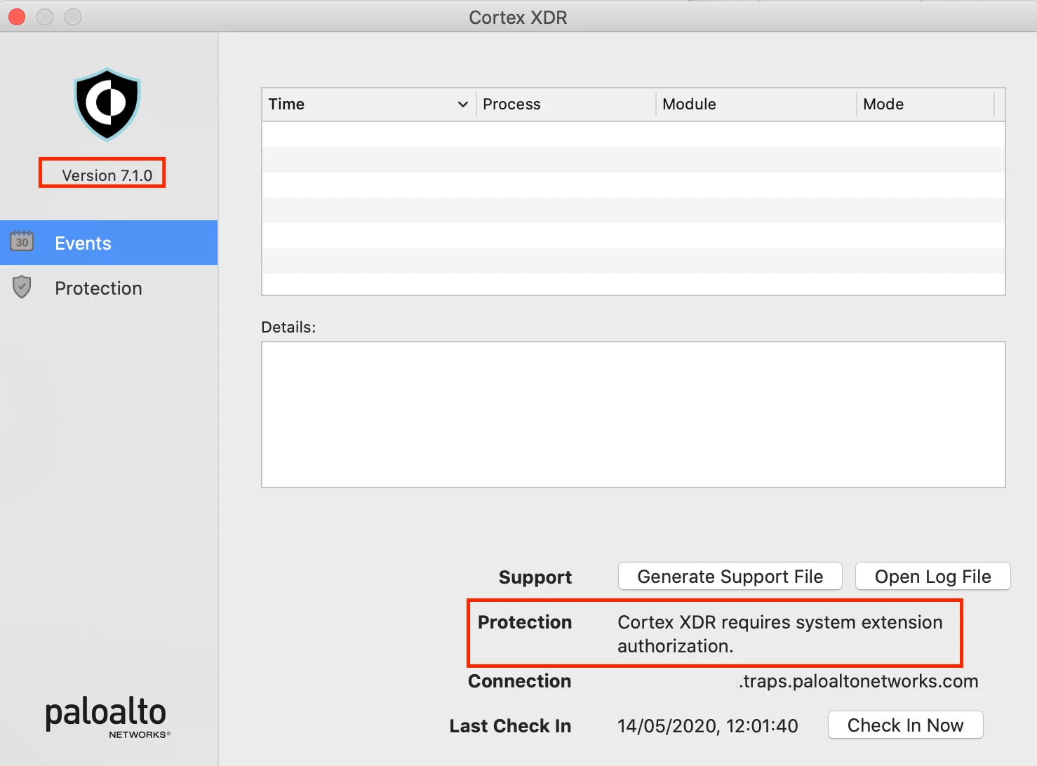

@davidhiggs When i deploy the 7.02 version with this configuration policy settings everthing works fine. But when we push the new update to 7.1.0 we get the following extension block.
Before this update everything was set to enabled and seems working fine.
Do you know if 7.1.0 needs more authorization.
The config policy works ok on 7.0.2

I created the Configuration Policy as described but somehow it keeps blocking and its driving me nuts 😃.
I have the same issue with the version 7.1.0 -- Cortex XDR requires system extension authorization. Also, I investigated that the application v. 7.02 has kproc_ctrl.kext in the /Library/Extensions/ folder. Now the app v.7.1 hasn't it, but we have two newest kexts bundles: com.paloaltonetworks.traps.securityextension and com.paloaltonetworks.traps.networkextension. However, I can't understand where the bundles are located
@osokhan They aren't kext bundles and not treated the same. You'll be adding them as system extensions via their bundleid so location won't matter. But if you're interested, they're inside the application in /Applications. If you follow the v7.1 guide linked above, you'll have no troubles. I've verified the original errors have been fixed by Palo Alto and working correctly.
I have followed the guide, and while it has worked for most endpoints, and all the tests I have made on a recently wiped machine, we are still facing issues in some cases, for example, when upgrading to Cortex to 7.1 from a previous version or upgrading from Mojave to Catalina: it is still prompting to allow the system extension.
I have triple checked the guide, created a separate profile with all payloads in a single config profile to apply to the affected machines, and still nothing, the prompt will not go away until manually approved.

I tried to install the Cortex 7.1 with the profile based on the Palo Alto manual (https://docs.paloaltonetworks.com/cortex/cortex-xdr/7-1/cortex-xdr-agent-admin/cortex-xdr-agent-for-mac/install-the-cortex-xdr-agent-for-mac-using-jamf.html#install-the-cortex-xdr-agent-using-jamf), but I am still in need to allow the system extensions. I hadn't had the macOS 10.15 Catalina upgrade from 10.14. However, I made the uninstall v.7.0.2 before attempts at v.7.1 installation. I made recreation of the profile a few times, but the manual doesn't work.
We have pushed the Cortex 7.1.1 update on one of the affected machines, and it has solved the issue. Everything in Jamf is configured as per PaloAlto's procedure (https://docs.paloaltonetworks.com/cortex/cortex-xdr/7-1/cortex-xdr-agent-admin/cortex-xdr-agent-for-mac/install-the-cortex-xdr-agent-for-mac-using-jamf.html)
The new agent came out. 7.1.1 today! Looks like the update resolved the issue.
Great to hear! I didn't see any bug fixes in the release notes, I wonder if deployment of an updated systemextension reset the issues some of you were having. I'll be pushing 7.1.1 too just in case.
