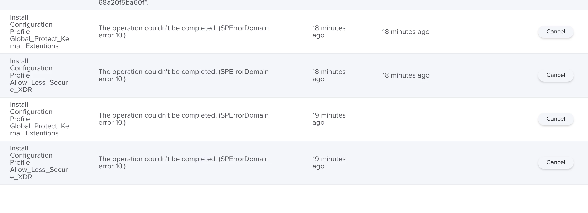

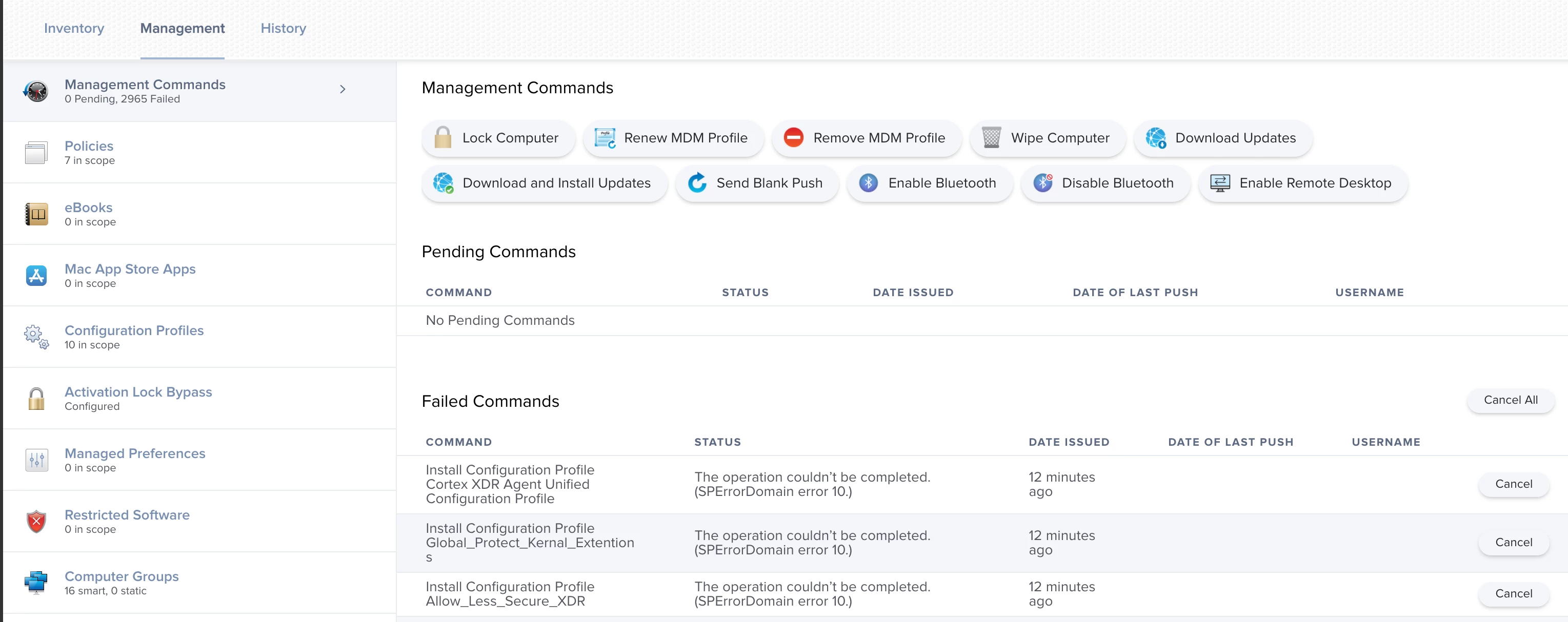

@davidhiggs have i am getting the error : The operation couldn’t be completed. (SPErrorDomain error 10.) while applying this config profile to M1 chip laptops and its failing. Do you have any suggestion on this error?
you shouldn't be doing any kernel (legacy system extension) whitelisting/approvals for cortex, should just be system extensions
@davidhiggs So for M1 processor how do i take it forward for the new installation and approval kernel extension?

@davidhiggs how we can handle the M1 processor laptop config profile setup. Because i have installed Rosetta on the M1 processor machines but the configuration profile not apply to the M1 processor
machines its failing.
@davidhiggs Any reason for this.
Do we need to create two different profile for M1 and normal inter processor?
Could you please guide me to solve this, and also i have applied few user to this config profile. After apply config profile few user wifi got disconnected from the internet automatically?

@udhayakumar
As Apple Silicon on Big Sur does not support Configuration Profiles with Kernel extensions, you need new profiles for M1 devices.
I cloned my Cortex Configuration Profile and removed the Kernel Extensions payload. This is then scoped for the M1 devices and my existing Cortex profile excludes M1 devices in the scope. I've done the same for any Configuartion Profile that has a kernel extension payload.
