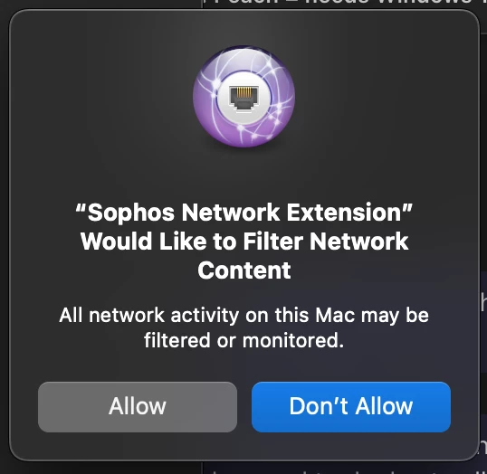

Has anyone figure out how to grant permission using JAMF to filter network content?
I granted Network Extension, but content (image below) is still prompting for permission.
Any help would be appreciated. MacOS version = Sequoia

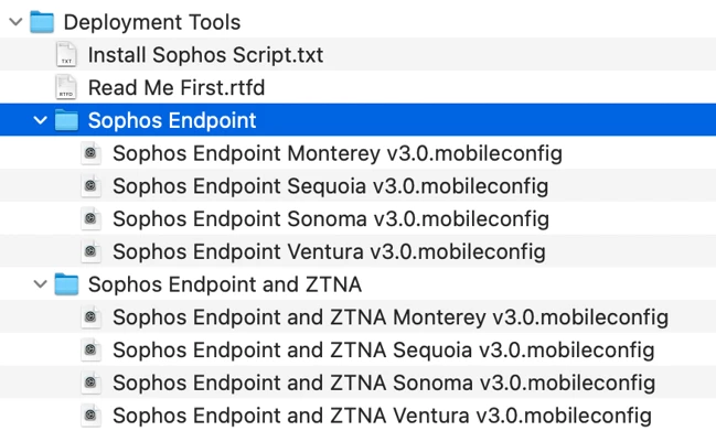

https://docs.sophos.com/central/customer/help/en-us/PeopleAndDevices/ProtectDevices/EndpointProtection/MacDeployment/index.html#download-macos-configuration-profiles
Download from the attached link and select the profile according to your OS, then deliver it via Jamf to the device or device group you manage.

​@agungsujiwo I did get the config file from there and i created a policy using that config. The issue i am having is, after granting network extension permission (using a config profile), i am still getting that pop up to grant content filter network extension access. Before deploying, i want to make sure that there’s no pop ups during deployment (reduce the chance of users selecting Dont Allow).
So my question is, after granting the net. extension permission with a config profile. How can i do the same for the content filter extension? I cant seem to find a bundle ID for the Content Filter Network Extension.
Thank you.
Thank you.
Hi ​@L0GAN876 ,
Things to note:
  1. The configuration profile must be delivered before installing the app to prevent any pop-ups. Make sure there are no pending items when sending the profile.
  2. Once the configuration profile has been applied, the next step is to send the policy to install the app.
Note: If an app installation policy is deployed before the profile, you will need to uninstall the app first.
