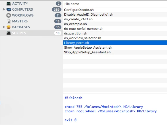

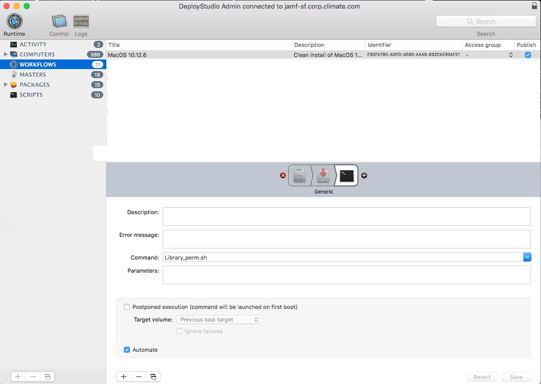

  • March 1, 2018
@ant89
Not working for me still. install still fails. Can you possibly post screenshot of your DS workflow?
  • March 1, 2018
@ooshnoo here is my workflow and script
  • March 1, 2018
@ant89 Thanks. That's exactly what I have, and it's not changing the permissions.
  • March 1, 2018
Weird. I was stuck on this too. but some help from the macadmins slack told me use the full path instead.
chmod 755 /Volumes/Macintosh HD/Library
chown root:wheel /Volumes/Macintosh HD/Library
Im not sure what your issue might be. Disabling SIP may fix it, but thats what i was trying to avoid in the first place.

  • March 6, 2018
@ant89
turns out if I add ANYTHING to workflow aside from applying the image and changing the permissions via script, the install fails. Even running a script (postponed) immediately following changing the permissions causes the permissions to be changed to root:admin
I'm dead in the water. I guess that's what I get for relying on open source. Deploy Studio has finally failed me.

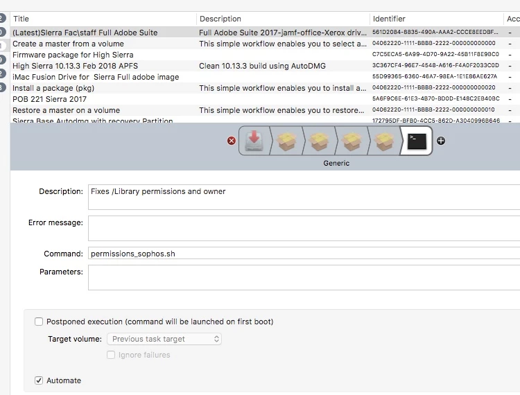

smcmjeff
  • March 7, 2018
Add me to the list. I continue to use DeployStudio to image older computers. On newer models we use DEP and PreStage Enrollments. One of our technicians noticed that the Sophos Cloud install package I put in Self Service was not installing on these computers. I eventually found this thread and checked the permissions. I fixed the permissions manually and I was able to run the latest Sophos Cloud Installer.
I created the script and tested it by netbooting a computer that had the incorrect permissions. I ran the workflow (consisting of just the script), and when the computer rebooted, the permissions were fixed. However, when I added it to my workflow, I initially placed the script directly after the "Restore" and before 4 different "Package" installs. After the workflow completed, I checked the permissions and they were still wrong. I took a chance, and moved the script to the end of the workflow (see image). I didn't think it would work, but it did. Tested on two different computers and it seems to be working.
I think DeployStudio is great. I was going to continue to use it to lay down AutoDMG's of clean OS's on older DEP and non-DEP computers to be able to get them back into production faster. Unfortunately, it has been a while since the last update. I am probably going to start to look at the imaging component of JAMF Pro.
