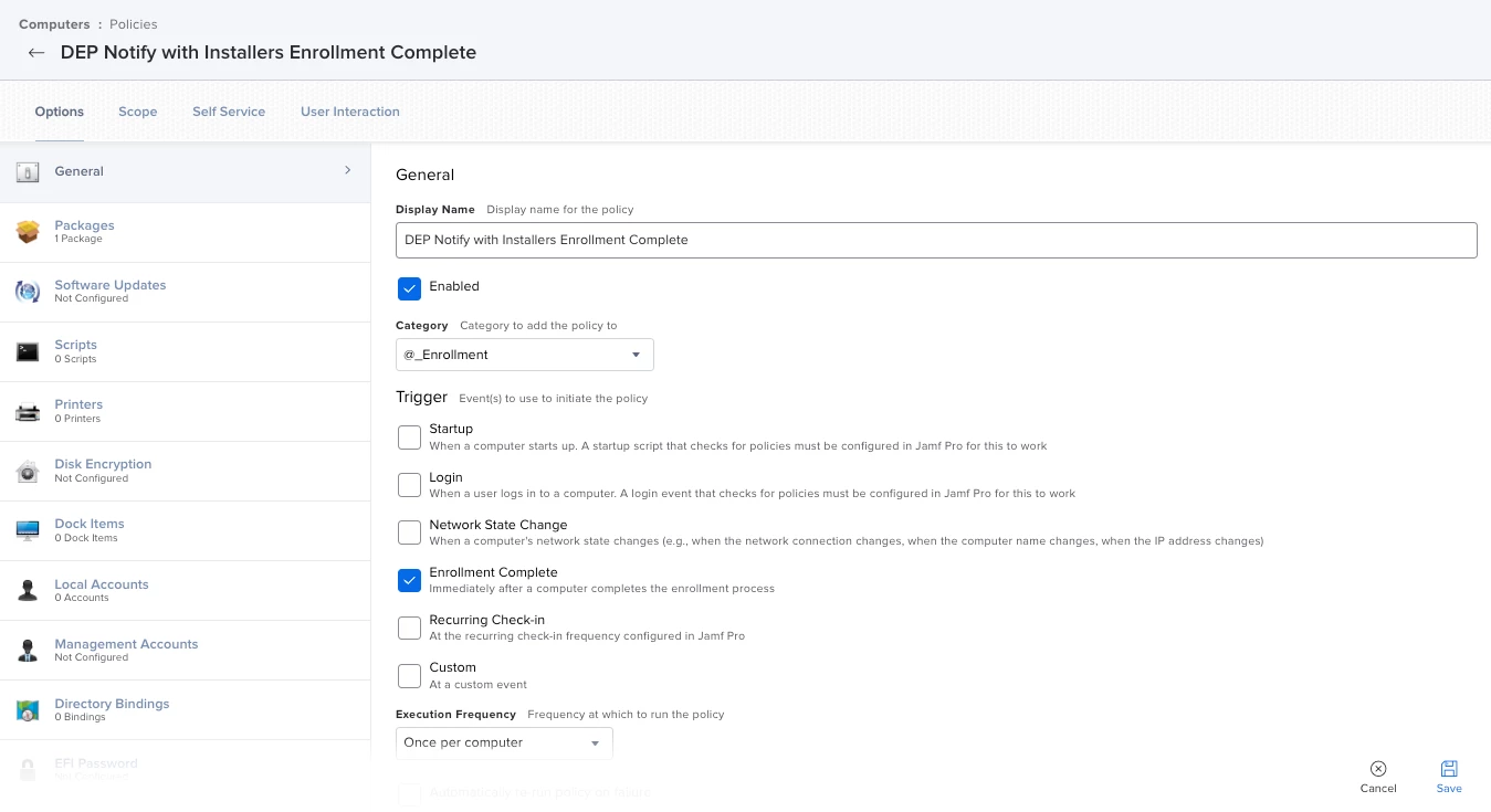

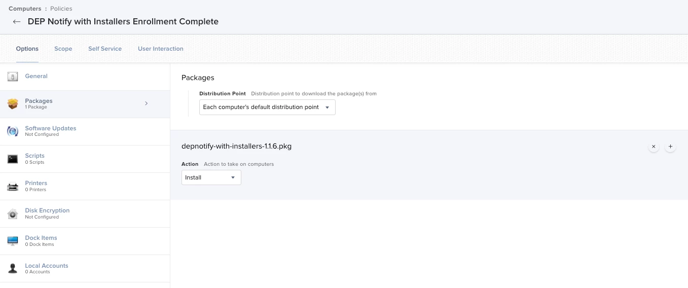

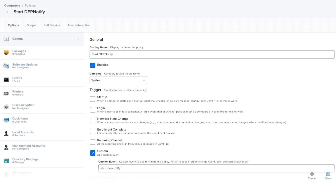

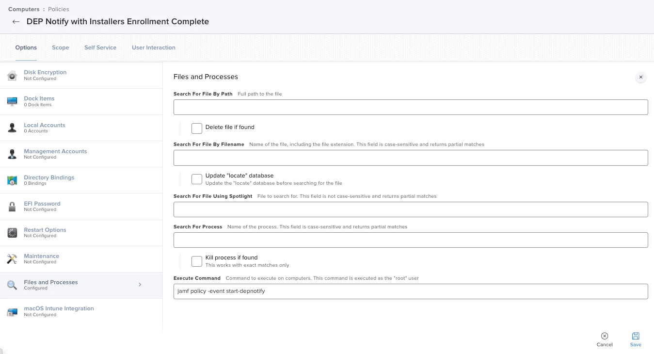

With help from a Slack channel I have my DEPNotify back up and running. I had my DEPNotify package in pre stage enrollment. I was asked to try to create a policy then add the DEPNotify package in there and have it run on "enrollment complete". I did this and removed the package from pre stage. I also added a custom trigger to point to the policy that has the script.

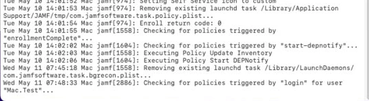

Is DEPNotify installed already on the machine before the script is run? We are deploying the DEPNotify package through prestage enrollment packages and having the script run after enrollment. We had to notarize the DEPNotify pkg in order for it to work correctly.  Also check the Jamf logs and see if the script is actually running during your deployment ( /var/log/Jamf.log)

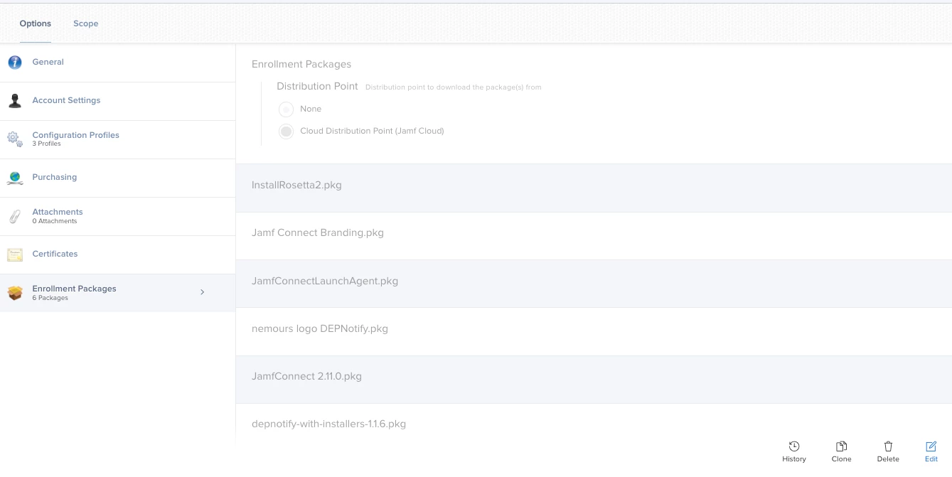

Yes. I deploy DEPNotify in prestage enrollment. Just tested and it still works with 12.2.1. Not working with 12.3.1

the log shows that the DEPNotify policy that holds the script has started.
