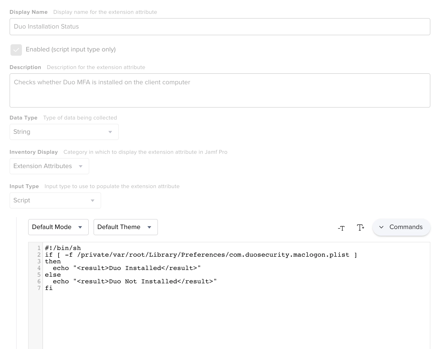

This sounds promising, Can you elaborate on the Extension Attribute?
I see how to make one just not sure where I would input the bash script?
WilsonFredonia
Below is what the EA looks like as ours is configured. Here is Jamf's documentation on creating EAs
