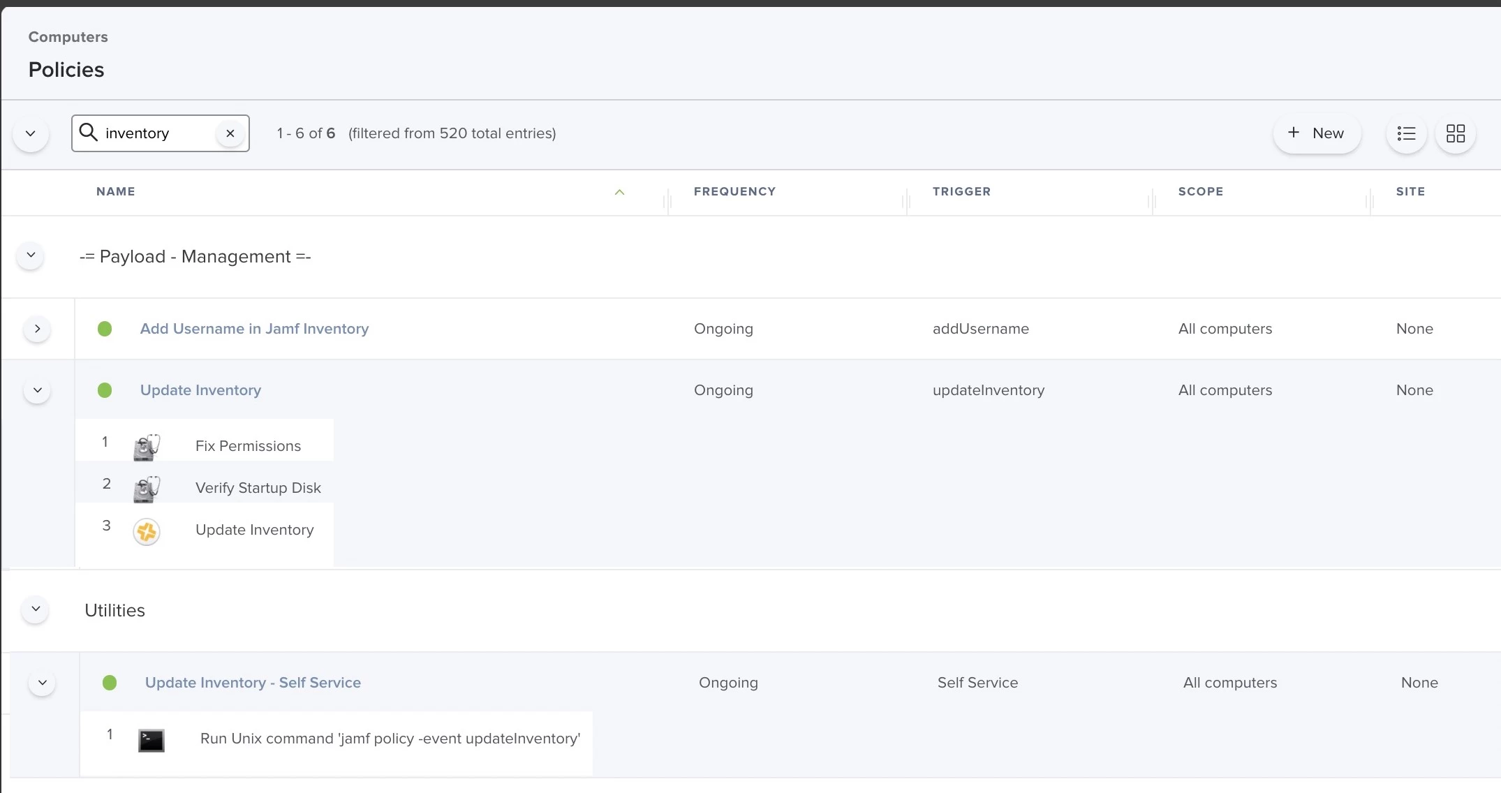

Interesting however you may want to consider a policy structure change to make it easier to determine if a policy is called by self service or by another trigger. Meaning, have you tried breaking up a single policy into 2 or more policies? For example, let's take an inventory update (aka recon).
Instead of a single policy with the trigger set to self service and the payload included, you can break it up to 2 policies:
- Payload Policy - Policy that is ongoing and with a custom trigger name enabled that has the 'payload'
- Trigger Policy - Policy that calls the Payload Policy and customized trigger. In this case, we enable just self service. Note, you can create additional trigger policies if you need to detect other triggers like reoccuring check-in, login, logout, etc.
This way you can grep the /var/log/jamf.log for any policy name that ends in this example with "- Self Service" in the policy title.
