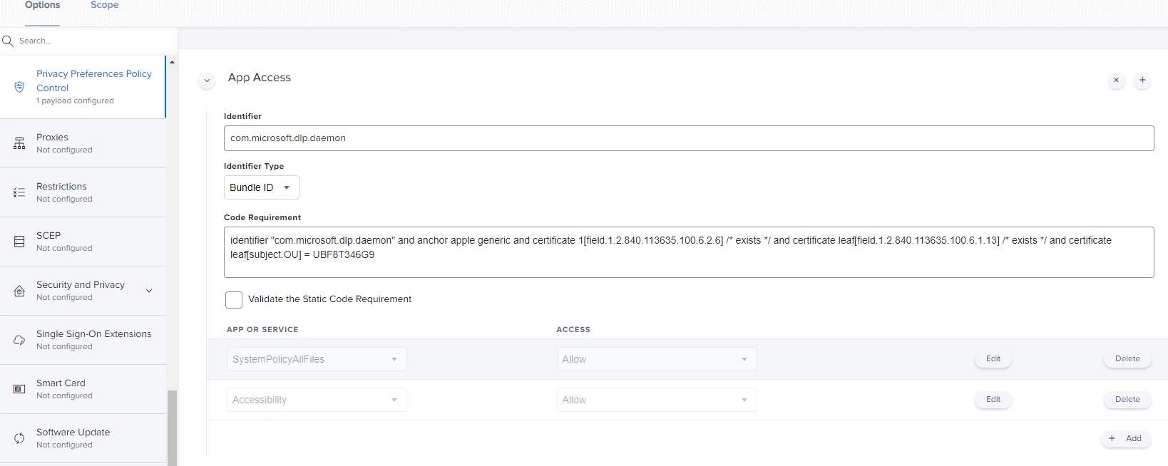

are you looking for the PPPC settings for DLP?
WilsonFredonia
I do have that baked in. It is using Microsoft's Schema, the section for Device Control requires a JSON string. I think my JSON is wrong since further troubleshooting with mdatp device-control policy rules list is showing as empty.
