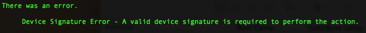

Upgraded from Casper 9.62 to 9.65, but started experiencing trouble when running recon via terminal. Anyone else run into this?
"Device Signature Error - A Valid device signature is required to perform the action.

I find I only see that error now, if time is off, or if i'm running recon before casper has actually finished the enroll on imaging.

As rderewianko said, I've noticed that when the time is slightly off it will give the error. Just like a kerberos token requires time to be synced, jamf requires it as well.
I usually just restart their mac and run recon afterwards which would correct the signature error it throws.

@dferrara ...@jjones....I found a pretty slick command line that eventually helped me get things back into sync.
Try these two commands from the mac you're trying to enroll:
sudo jamf enroll -verbose
then...
sudo jamf enroll -prompt
This should prompt you for the JSS login, and password.
Eventually I could recon the system, and I didn't get the device error message.

I've seen this in our environment occasionally when we forget to plug in a network cable after the imaging reboot. I've also had to do the sudo jamf enroll -prompt method when it happens.
  • January 11, 2016
Can confirm that the 'Sudo jamf -enroll -prompt is successful in stopping the errors.. Just had the same issues here.

I found if I removed jamf:
sudo jamf removeFramework
...and ran the QuickAdd installer again, it got rid of this error. Our JSS cert is self-signed which may also be a factor. I recently had to renew the cert. We are using 9.82.

  • November 3, 2016
Does anyone know what causes this Device Signature issue? As we are starting to see this occuring when we are reimaging some of our Macs.
@DanJ_LRSFC is the JSS SSL cert internally signed? I've seen this immediately after imaging myself, usually if autorun imaging is set:
$sudo jamf policy -verbose verbose: Error Domain=com.jamf.jamfsecurity.error Code=-25300 "The specified item could not be found in the keychain." UserInfo={NSLocalizedDescription=The specified item could not be found in the keychain.}
There was an error.
Device Signature Error - A valid device signature is required to perform the action.
