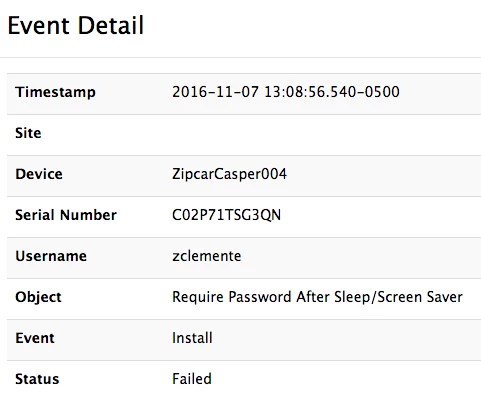

We're having the same issue here. Sierra machines appear to fail the policy for locking after 5 seconds where our El Capitan machines are fine - on v9.96.

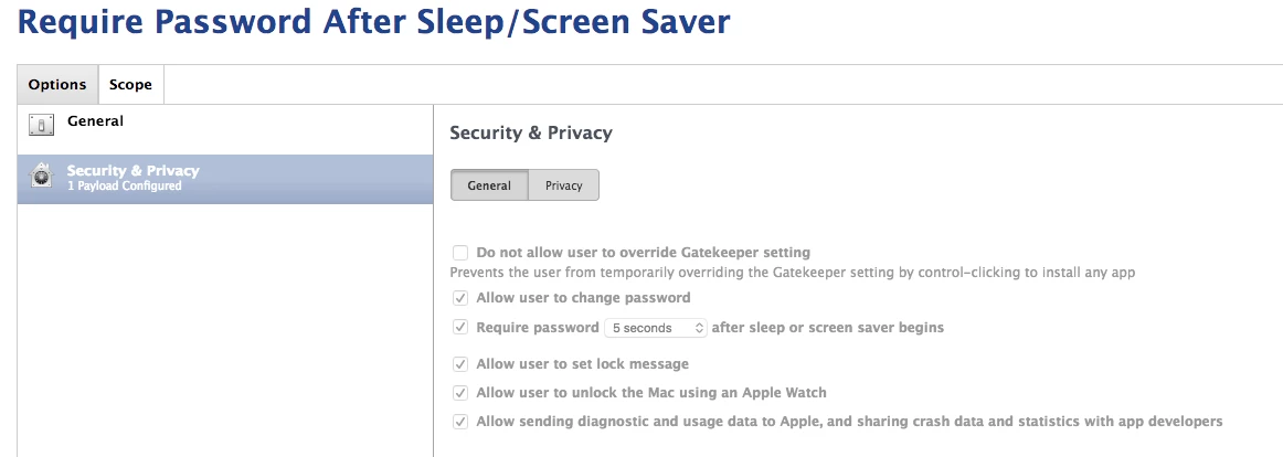

@zipcar Are you using Casper's builtin profile configuration or are you also using a customized profile payload?

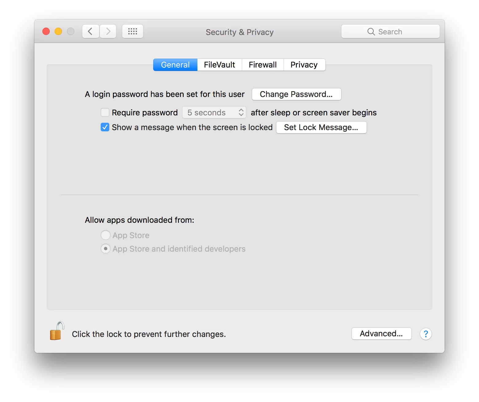

@jhuls Using the built-in profile config
I'm not sure how to get more detailed logs beyond this.
It's worth noting that a fresh Sierra install -> enrollment and using the Casper Imaging with built both have this problem where the setting is greyed out on the client, even if you've unlocked the screen.
However, if I take a managed El Capitan client with the setting already active and update it to Sierra - the setting stays and works.

@zipcar Have you tried switching that profile over to apply at the computer level to see if it works? That's what I'm using.

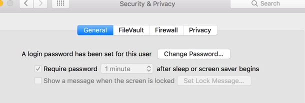

@zipcar Have you looked at the Profiles system preference on the client to make sure it's showing up correctly there?

@jhuls yeah, looks like it's deployed (before it would fail deployment) and...it's suddenly working? I haven't changed anything since replying two days ago so I'm a bit confounded.
  • November 10, 2016
@jhuls lol spoke to soon - restarted to validate and it's turned off again.
  • November 10, 2016
@jhuls looks like when I restart the computer, the profile stops working but then over time (or if I force a redeploy) it'll work again.
