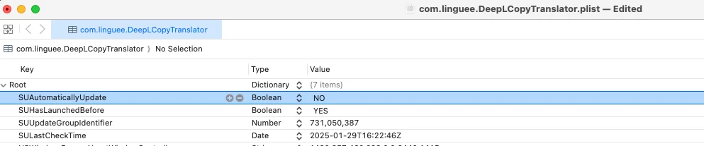

Hi @Jacek_ADC ,
Check for "SUAutomaticallyUpdate" key in com.linguee.DeepLCopyTranslator.plist. Try setting it to False using defaults command.
defaults write com.linguee.DeepLCopyTranslator SUAutomaticallyUpdate -bool false
Thanks.

Jacek_ADC
  • Feb 6, 2025 7:26 AM UTC
@karthikeyan_mac
Thank you for your idea. I tested but auto update cant be disabled. I was also one week writing emails with deepl support (just terrible support). So finalizing this, deepl app has no function or key to disable this.
I just received around 5 workarounds with different tools how i can manage this. But this was never my question.
So thank you for your help.
