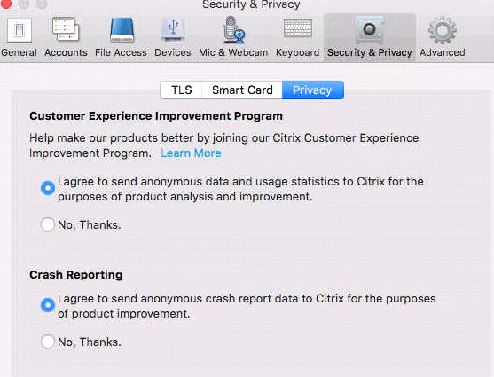

Hi,
Can you help me with disabling these option?
Reconnect apps when I start or refresh apps – this option is checked by default, it needs to be unchecked
Under privacy tab, both option needs to be “No thanks”
(first is the CEIP)
Command for this is : defaults write com.citrix.receiver.nomas CEIPEnabled -bool false
When we run this command on terminal, It gets changed to No, Thanks from I agree. This is only happening for CEIP which is the first option. We would need to find the command for Crash Reporting which helps to change it to No, Thanks from Crash Reporting.
Option to notify for upgrades needs to be disabled (it is enabled by default)

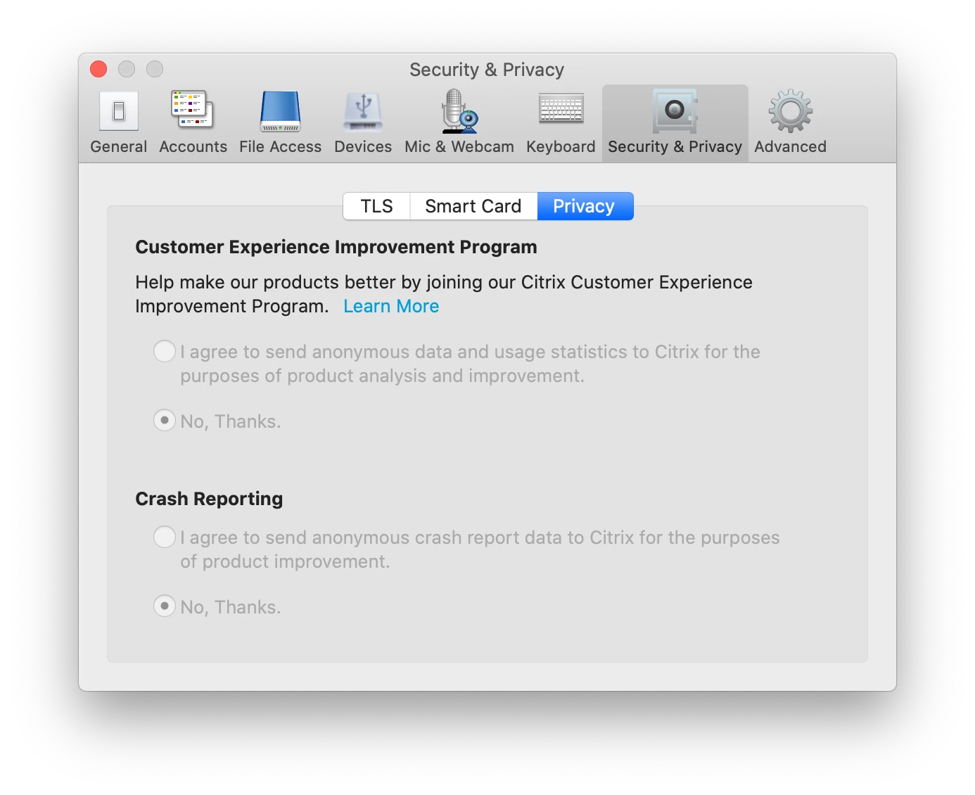

@namrata_ponnam you must have them applied through your MDM solution as Managed Preferences so called Configuration profile (OR) in other terms, Payload profiles.
I understand you like to keep CIEP and Crash reporting set to default as "No Thanks", I paste the screenshot here.
Please try this key "CrashReportingEnabled" and boolean value as NO/false
<plist version="1.0">
<dict>
<key>AutoUpdateState</key>
<string>Disabled</string>
<key>CEIPEnabled</key>
<false/>
<key>CrashReportingEnabled</key>
<false/>
</dict>
</plist>
