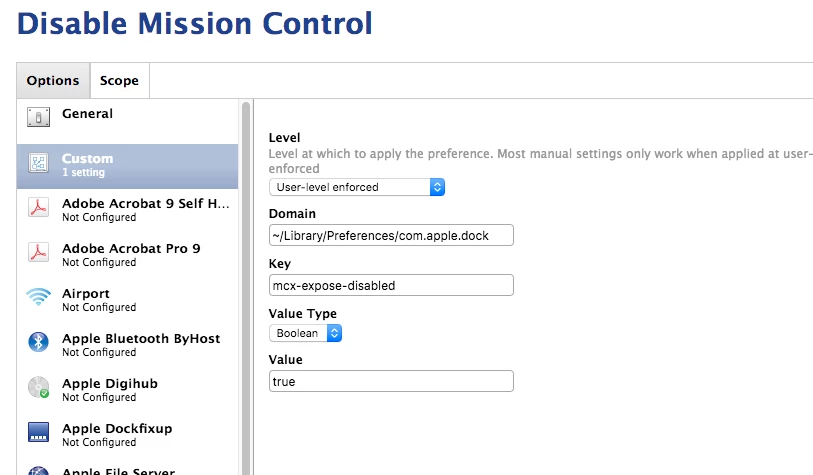

For MCX, try these steps-
1. Create a new Managed Preference, choose Create Manually
1. Enter a name and description on the first tab, then click on the Definition tab
1. Choose User Level - Allowed and User Level Managed - Allowed
1. For Domain, enter: com.apple.dock
1. Key Name: mcx-expose-disabled
1. Change the Key type menu to "Boolean"
1. Now click back on the General tab and you should see the following settings-
  • Apply Setting to: Make this preference unmanaged (with options for 3 different User Level settings under the menu)
  • Domain: ~/Library/Preferences/com.apple.dock
  • Key: mcx-expose-disabled
  • Value: True / False
Just set those to the ones you want. For example, to User Level Enforced, and True, add in a Scope to a test group and see how it works.
Note that not all preferences can be user level enforced, but I'd try that first to see it it forces and locks down the setting on your user systems. If not, you may need to change to it User Level at Every Login for example.
For making this into a Config Profile, its a little more involved and I wouldn't be the person to guide you on that. There are some threads about adding in custom MCX stuff in Configuration Profiles. I just haven't done that much at all.
  • November 20, 2012
Hot diggity, I think that did the trick! Thanks for the clear and concise instructions! Making use of a custom MCX translated a bit of Greek to me and may make MCX more usable for us in the future too! Thanks Mike!
