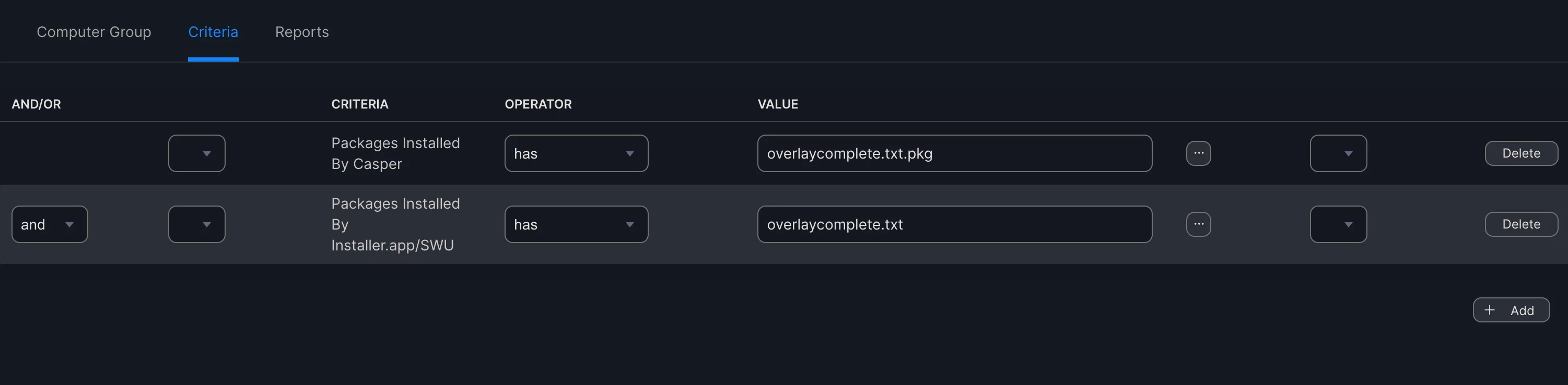

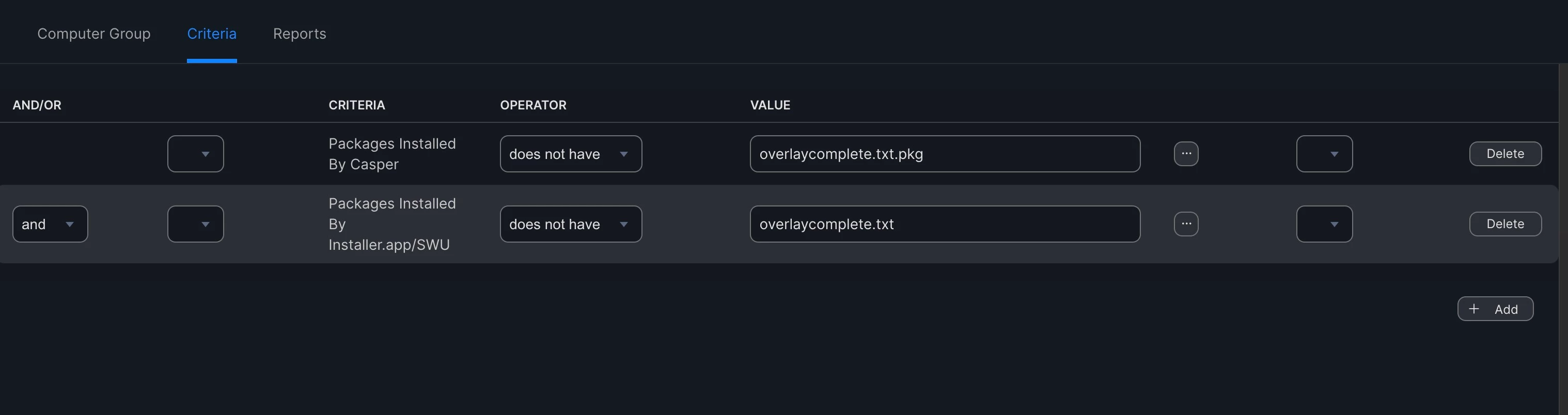

We also have a policy that drops a file on the Mac at the end of the enrollment process. We use the receipt for the install of the file in a different Smart Groups for Macs that are "Enrollment Complete" or "Enrollment Not Complete". We also use that group as exclusions for policies we don't want to run during enrollment, we don't want running if the Mac isn't correctly/fully enrolled, or we don't want a policy showing in Self Service if the Mac isn't correctly/fully enrolled.
