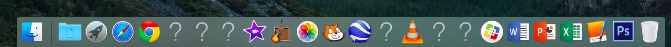

I have just created a new build of OS X 10.11.4 and I have pushed out a dock configuration for some computers but I'm seeing questions marks appearing on them for dock items that are apart of another build. anyone got any suggestions?
5 replies
  • May 10, 2016
Those are dock items delivered that don't exist on the target machine (or the path doesn't quite match).
If you planning to do any complexe dock configuration it's really worth learning how to use dockutil, it's complex but once you sort it it's great and it deals very cleanly with missing items.
