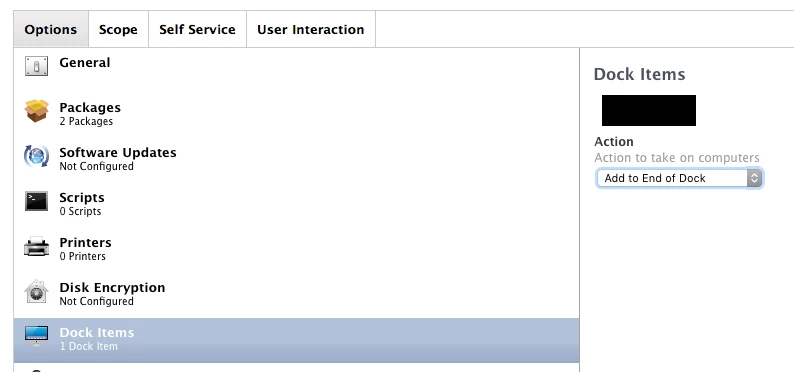

@tcandela Trigger? I do not use DockUtil but settings in policy on JSS:
