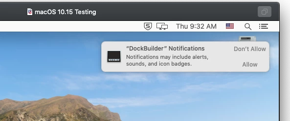

So after wasting a day trying various options to get a customized Dock for users in Catalina, I've settled on DockBuilder. It works well enough, but when a user logs in and it runs, they get a notification asking if they want to get notifications from DockBuilder. Is there a way to prevent this? I want DockBuilder to be as invisible to users as possible.

Here's what I'm getting. Happens once for every user who logs in. I'm also seeing, intermittently, where DockBuilder will do its thing but the stock Catalina apps (Maps, Photos, News, Podcasts and TV) will remain -- I'm guessing this means DockBuilder is simply running too early.

@cwwirth You can use ProfileCreator to manage these settings. There is a write-up here on how to do it:
https://mrmacintosh.com/how-to-manage-catalinas-new-application-notifications-with-a-profile/

Okay I will need to look at it. It doesn’t use Notification Center so it is odd that it prompts. @FritzsCorner is right about ProfileCreator but I’d like to see if I can eliminate this or at least see why it does that. If it is not preventable I can at least create the profile and add that to the repo with instructions.

@FritzsCorner thanks for that...using the talkingmoose script to build a profile works perfectly.
@ryan.ball I'm coming across a problem where DockBuilder isn't setting the breadcrumb prefs file for the users, so it runs every time someone logs in and rebuilds their Dock. I tried changing $HOME/ in the build script's breadcrumb and log paths to ~/ but that didn't make a difference.
