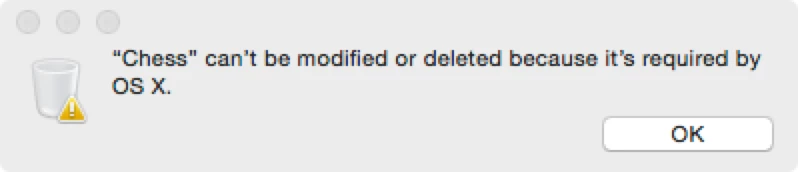

And for that matter, please allow me to delete Applications which have no purpose on my machine: Messages, iTunes, iBooks, Game Center, FaceTime, Quicktime Player...to name a few.
Contrary to the message from Apple, there is absolutely no reason they should be "required by OS X" and it just goes to show that it is not about letting users run their computers as they desire.

@mikeh - If Apple modifies my dock, it is about them dictating my wants/needs, because I had the dock I wanted and needed. I already have a dock, they don't need to market to me.
You know what else IS dictating wants/needs? You can't tell me this screenshot makes any sense whatsoever. Stop wasting space with this, and all the other crap I have no use for but apparently can't delete...

Chess.app (and all other default applications installed with the OS) are specifically listed as protected by SIP in the /System/Library/Sandbox/rootless.conf file.
I would agree it seems very silly for Apple to put up the SIP wall on something as innocuous and useless as Chess.app. The only possible reason I can think of for doing this is, Apple is worried a piece of malware could remove and add a new compromised version of Chess.app, or any other default OS X application on a Mac, and when its run by the user does something nefarious. Seems a bit spy vs spy like to me, but that's really the only reason I can come up with for being that stringent in what it protects.
FWIW, if you boot the Mac to another boot volume, even a 10.10.x OS, you can easily delete Chess.app or any other default app and then reboot back into El Capitan and the OS won't miss it at all. In fact, Arstechnica did just that in their full review of El Capitan.
