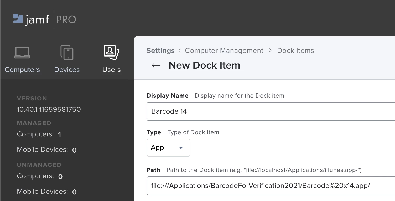

I suggest using the Dock Items Payload within a Policy to remove the app.
Located in Jamf Pro Dashboard -> Settings -> Computer Management -> Dock Items
Add your App as depicted below. Then Create a policy with the dock items payload, select your app that you just added & test removing.
If the path shown in your script above is indeed the location of the application, the path will be as follows.
 Path: file:///Applications/BarcodeForVerification2021/Barcode%20x14.app/
