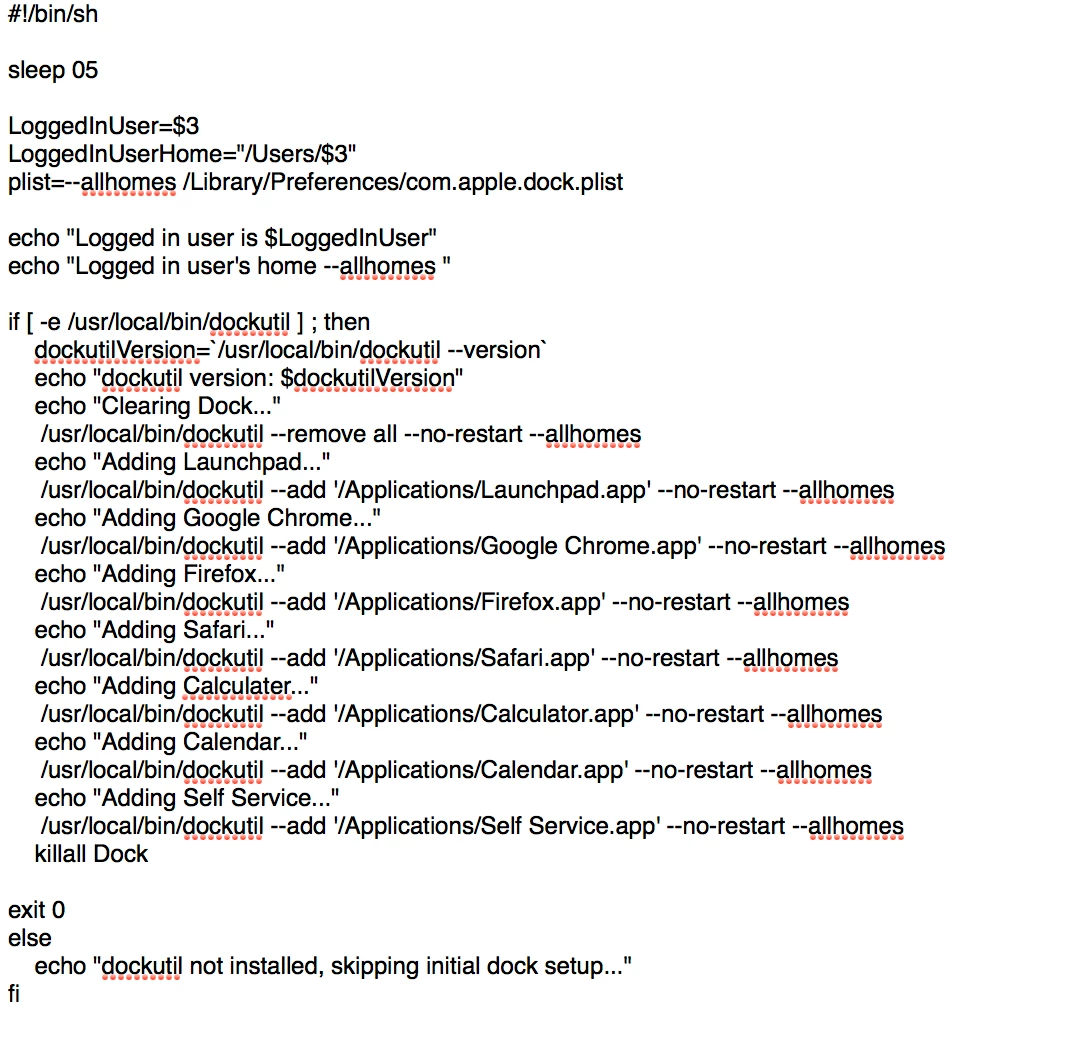

Having a problem with dockutil version 2.0.5 on a new iMac 2017 running 10.12.6 casper version 9.96, the same script runs perfectly on older iMacs but on the new one the only item that seems to work is the "killall Dock" command.
This is a cut down version of what we want on the dock, just using it for testing.

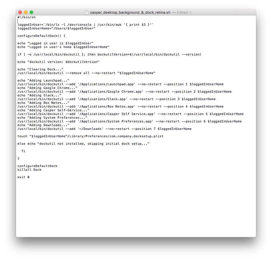

Can you post the raw code? So it is copyable?

@StoneMagnet thanks, I was rushing to a meeting so I just threw that up really quick.
Here you go.

@Echevarria How is this being triggered in your policy? Login hook?
Don't forget to use the code block feature when pasting code, or it will get mangled in the post.
@rqomsiya
I have this running as part of the setup process (imaging). I also have another policy that runs peruser. This way if a new account is created on the machine, the user will get the standard dock. I have it run at login.
@Echevarria I have tried that script and am getting this error
Script result: /Library/Application Support/JAMF/tmp/P112 Dock copy: line 3: -l: command not found
if I take out the -l I get
Script result: /Library/Application Support/JAMF/tmp/P112 Dock copy: line 3: /dev/console: Permission denied
My appologies to all who have contributed, dockutil is working fine there was a Configuration Profile overriding any changes that I tried to make.
