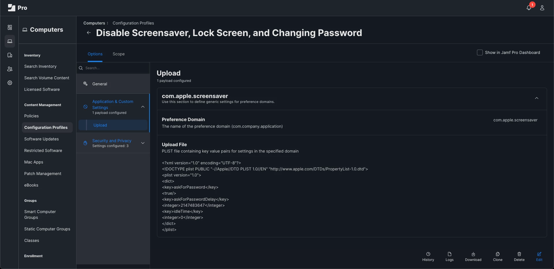

To answer @iamYaje 's question: the domain we want to apply these changes to is com.apple.screensaver. More info can be found here:
https://developer.apple.com/documentation/devicemanagement/screensaver
https://developer.apple.com/documentation/devicemanagement/screensaveruser
However, I was not able to get this to work using @Mike4's settings. Specifically, I had to change the value type for 'askForPasswordDelay' from 'real' to 'integer', per the documentation linked above. After that, it works perfectly. Maybe Apple changed something in an update and 'real' is no longer valid. I tested on OS 14.2.1.
I also added an extra key to disable the screensaver completely (why in 2024 Apple doesn't just have the screensaver disabled by default is mindboggling). These settings will accomplish that:
<key>idleTime</key> <integer>0</integer>
Note: this setting is listed on the docs as applying only to the user's individual screensaver settings, but adding the key to the computer-wide 'com.apple.screensaver' plist works just fine.

I don't have any insight regarding doing this manually using Defaults or something else. We use Jamf Pro to deploy this as a configuration profile at the Computer level. It seems to work without issue on OS 14 machines, and the very few OS 15 machines we have deployed.

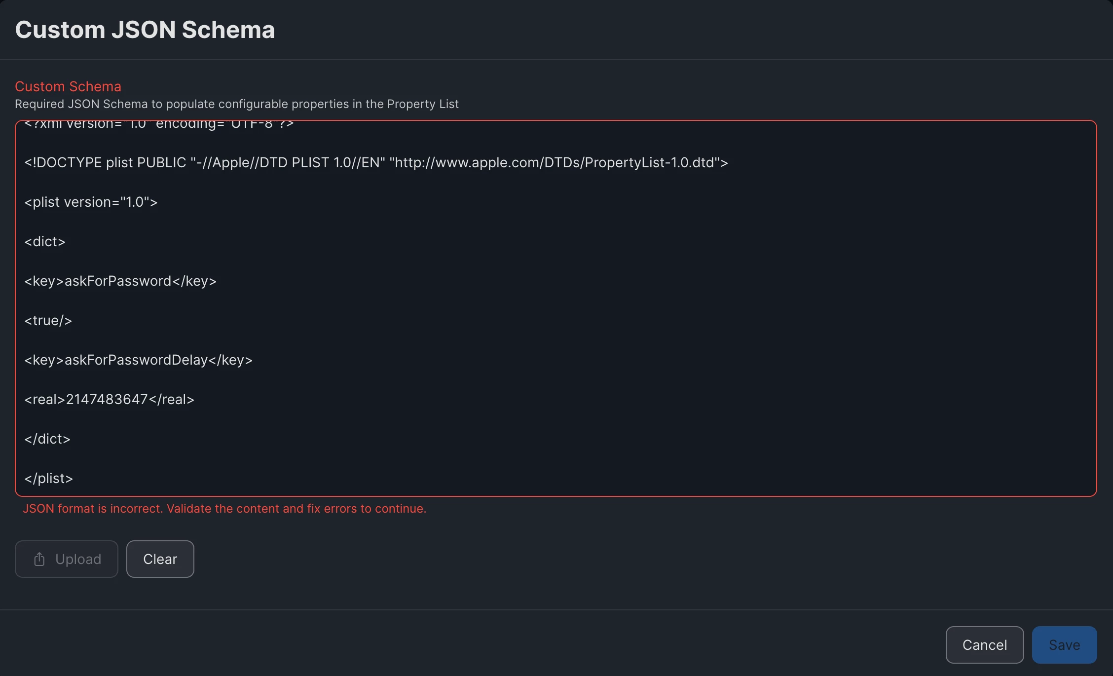

I guess I don't know how to take that and turn it into something Jamf can deploy. Inputting it as a custom schema just gets rejected.

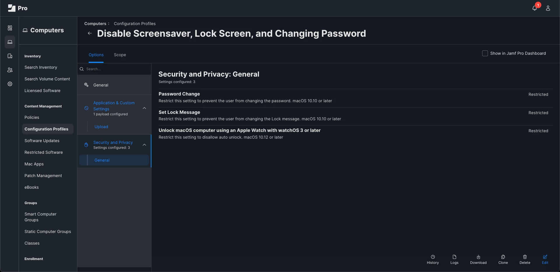

Ah I see. While you can use JSON schema to configure settings, the format is different. As I am a noob when it comes to JSON, I can't help you with that. But here is the profile I was referencing; I hope this helps. Just make sure the profile is set to "Computer Level."
If all you're trying to do is disable the screen lock timeout, the Security and Privacy settings are optional. We just decided to lump them all together since all our "shared" machines should get these settings anyway.
Ah, it never even occurred to me that you'd have to go to the "Upload" section to input XML code. I didn't see anywhere other than the JSON section and thought it must be that.
A configuration profile as set up in the screenshot above is indeed working perfectly as intended on 14.5.
