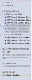

Another simple way: use Casper Admin to create a local repository and all scripts will be there :)

@m.entholzner good to know. Do you have to replicate the DP to the local drive to get them? Does it still copy them if the scripts are stored in the database?

@davidacland: yes, the DP replication will get all files from the fileshare as well as the scripts stored in the database.

@m.entholzner is correct. Using Casper Admin and then dragging a local folder into the lower right allows for local syncing of all Packages and Scripts. It does copy down all of the scripts that are stored in the JSS Database.
Unfortunately, it required me to wait for all 187GB of packages to verify that the scripts are copied down too. :)
This worked great for me as well. However, I did want to note that in my case I had to drag the folder to the lower left hand of Casper Admin.
