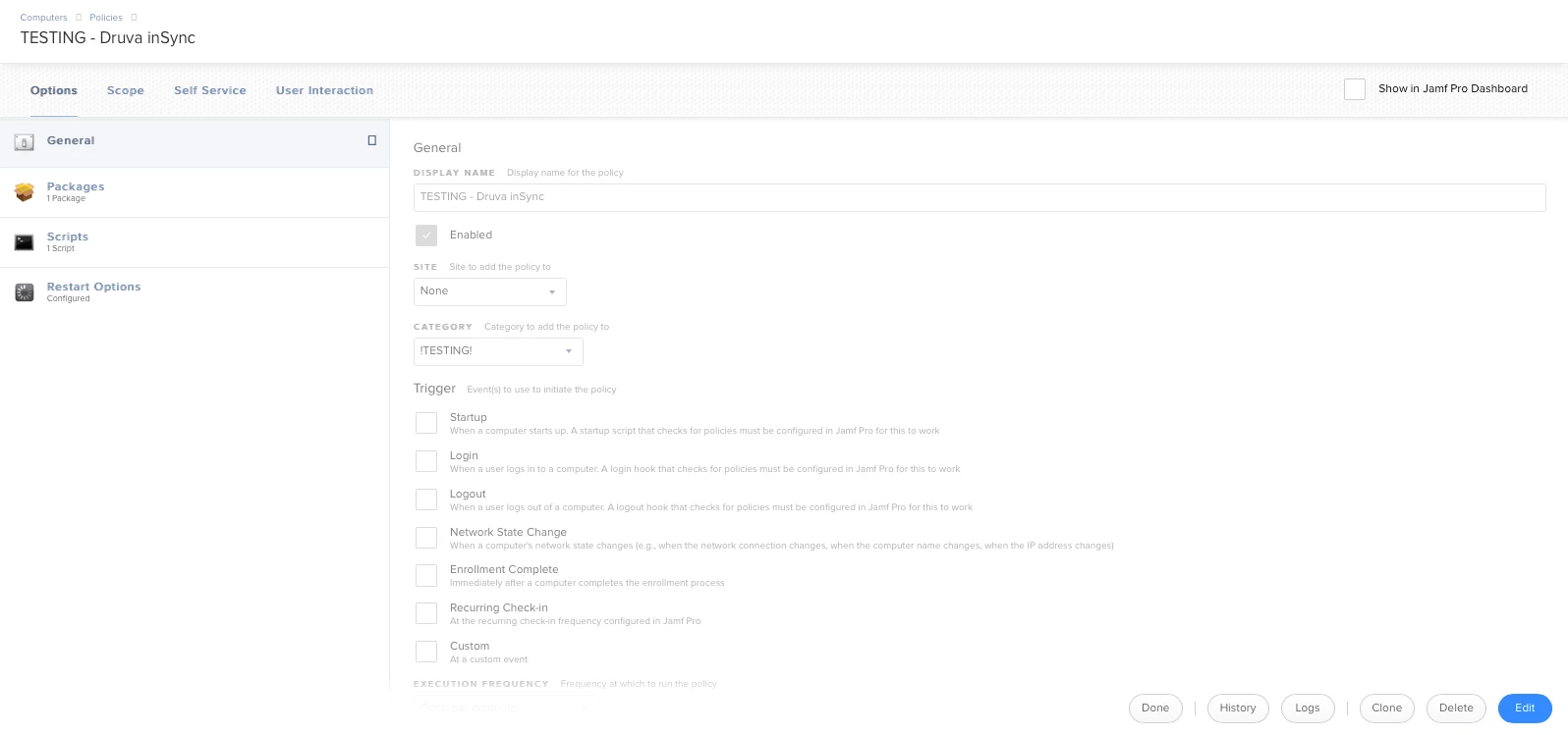

Your DRUVA Consultant should point you to
https://docs.druva.com/001_inSync_Cloud/Cloud/020_Backup_and_Restore/010_Set_up_inSync/070_Other_Features/020_Integrated_mass_deployment_of_inSync_client/040_Install_inSync_client_for_integrated_mass_deployment/040_Install_inSync_on_Mac_laptops
The CSV is one part and thenthere is the JAMF policy that will deploy and install the inSync Druva client. There is an activation code that is mention that you Consultant will give you to place into that code to activate.
