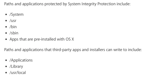

/Applications/Utilities/ is not protected by SIP, though the Apple-installed applications inside that directory are SIP-protected. That appears to be a mistake in the documentation, and I've filed a bug report for it:
http://www.openradar.me/radar?id=6126412251529216
Apple has a KBase article which was posted on ElCap's release day that correctly lists what's protected and what's not:
https://support.apple.com/HT204899
mm2270
  • October 2, 2015
Thanks for the clarification on that @rtrouton It was indeed confusing the way had published that originally. Good to know we can still deploy any custom apps into Utilities. Just can't touch the Apple provided ones.
