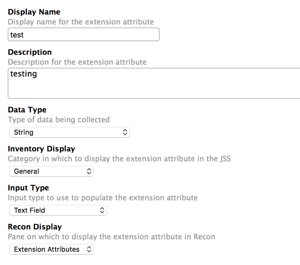

Coming around to this again as I try to figure what I am doing wrong. what are the setting I should set for the extension attribute inside the JSS console.
Because I am still not getting the data into the EA. it shows up under the general tab under my machines but I do not see anything in the field for the specific machine I run this script davidacland showed above
