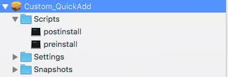

@moiz.qureshi You really shouldn't need the separate install.sh script. In Composer, if you click the disclosure triangle (see attached screen shot) to show the scripts portion under your package you can add a post install script and put the sudo sh /private/tmp/Confer/cbdefense_install_unattended.sh -i "/private/tmp/Confer/CbDefense Install.pkg" in the post install script. Save your changes and then rebuild the pkg file and you should be good to give it a try.
  • April 4, 2017
Sweet! All methods work, but I ended up doing what you done @mpermann . Thanks all!
