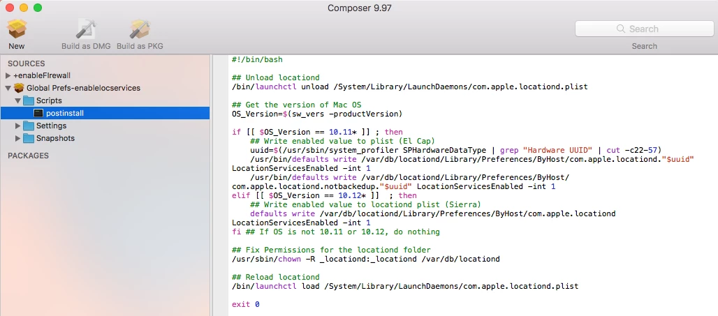

@JayDuff Thanks for sharing your script, Jay. I was working with it in a different manner on yesterday and figured out a pretty slick way to package the script to enable location services in system preferences/security & privacy/privacy so that its a sure-fire hit everytime.

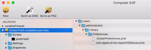

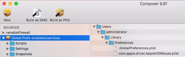

In composer...
Select “new
In the left-hand column select: User Environment “Global Preferences”
This will create the necessary plist “.GlobalPreferences.plist” and seat it under:
/Users/administrator/Library/Preferences/…
You will also notice a second plist under preferences “com.apple.driver.AppleHIDMouse.plist” (which is the action that executes the enabling of the location services feature)
Click the down arrow under the newly created Global Preferences pkg and right click on the scripts folder.
Now, add a “postinstall” script template and insert the following:
!/bin/bash
Unload locationd
/bin/launchctl unload /System/Library/LaunchDaemons/com.apple.locationd.plist
Get the version of Mac OS
OS_Version=$(sw_vers -productVersion)
if [[ $OS_Version == 10.11 ]] ; then ## Write enabled value to plist (El Cap) uuid=$(/usr/sbin/system_profiler SPHardwareDataType | grep "Hardware UUID" | cut -c22-57) /usr/bin/defaults write /var/db/locationd/Library/Preferences/ByHost/com.apple.locationd."$uuid" LocationServicesEnabled -int 1 /usr/bin/defaults write /var/db/locationd/Library/Preferences/ByHost/com.apple.locationd.notbackedup."$uuid" LocationServicesEnabled -int 1
elif [[ $OS_Version == 10.12
]] ; then ## Write enabled value to locationd plist (Sierra) defaults write /var/db/locationd/Library/Preferences/ByHost/com.apple.locationd LocationServicesEnabled -int 1
fi ## If OS is not 10.11 or 10.12, do nothing
Fix Permissions for the locationd folder
/usr/sbin/chown -R _locationd:_locationd /var/db/locationd
Reload locationd
/bin/launchctl load /System/Library/LaunchDaemons/com.apple.locationd.plist
Lastly...
Add the script to the postinstall script template and build as a PKG
You should now have a package that you can drop into Casper Admin
Hope this helps also.
