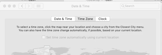

I'm going to pose an additional question here as well. I am working with my Jamf Buddy but can anyone share how to enable Set time zone automatically using current location in System PreferencesData & TimeTime Zone?

@sateshb you can use this:
/usr/bin/defaults write /Library/Preferences/com.apple.timezone.auto Active -bool true
Thanks for getting back to me Steve, I tried that but didn't make a difference. Ran Composer to take a before and after snapshot and don't see the com.app.timezone.auto plist in the list. Can't imagine where this preference is hiding.

Hi, I was able to configure Location Services and configure automatic timezone using the following lines.
A restart is required because restarting the related launchdaemons is no longer possible because of SIP.
enabling location services
/usr/bin/defaults write /var/db/locationd/Library/Preferences/ByHost/com.apple.locationd LocationServicesEnabled -int 1
uuid=/usr/sbin/system_profiler SPHardwareDataType | grep "Hardware UUID" | cut -c22-57
/usr/bin/defaults write /var/db/locationd/Library/Preferences/ByHost/com.apple.locationd.$uuid LocationServicesEnabled -int 1
/usr/bin/defaults write /Library/Preferences/com.apple.timezone.auto Active -bool YES
/usr/bin/defaults write /private/var/db/timed/Library/Preferences/com.apple.timed.plist TMAutomaticTimeOnlyEnabled -bool YES
/usr/bin/defaults write /private/var/db/timed/Library/Preferences/com.apple.timed.plist TMAutomaticTimeZoneEnabled -bool YES
/usr/sbin/systemsetup -setusingnetworktime on
/usr/sbin/systemsetup -gettimezone
/usr/sbin/systemsetup -getnetworktimeserver
