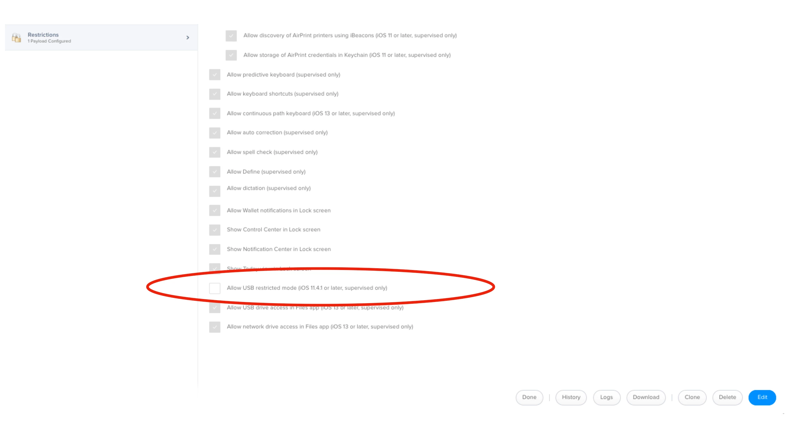

Do you have allow USB Restricted Mode enabled via restrictions profile?

I don't even know what that is USB Restricted Mode, so therefore I must say I don't have that enabled.
  • December 2, 2019
@cpominville Approximately 6 months ago (somebody correct me if I'm wrong here) USB restricted mode was automatically added to the list of available restrictions. Double check your restrictions. Your solution is "woo".
"therefore I must say I don't have that enabled". Do you think you're the first person to have this problem? Why would I, someone you don't know, bring it up?

I read up on it....I see it on the iPad itself.
Now to see if it's also a feature you can configure or not in profiles...
  • December 3, 2019
And it is.....but do we want that "off" in the event of a burglary of my boss's iPad? Go with Apple, leave it on...by default.
  • December 3, 2019
I asked my Apple Rep, "What is this even for?". Imagine the usb charging stations you see at an airport. Or in a restaurant. This prevents careless users from plugging into some random cord and exposing themselves to a security breach/unwanted sync.
Anyways, at our school, we use Configurator 2 when an iPad gets borked. If you have this restriction on, you end up being kinda stuck if you've got a WiFi issue (profile removed, etc). If JAMF can't talk to it, a mac running configurator 2 can (under the right scenario - specifically establish trust between the Configurator machine and the iPad ahead of time).
