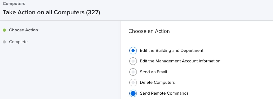

and:
To do this for individual devices and or more than one device use an advanced search and target the device's name and then save it then run the remote commands on them.
