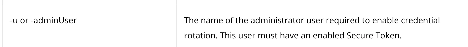

Hi thanks for the reply! According to CyberArk, the -adminUser & -adminPassword are required when creating the PKG. If they aren't included, devices will not get added in the vault and the password will not rotate. Is this not true?
Within CyberArk's Documentation, if you use -adminUser, a Secure Token (FileVault) is required.
This comes from their documentation here: https://docs.cyberark.com/Product-Doc/OnlineHelp/EPM/Latest/en/Content/Installation/macOS-InstallAgents.htm#Install
And in order to enable that FileVault Secure Token for the local admin user account, it requires manually intervention from each user. And that isn't an option considering we have 800+ MacBooks to configure.

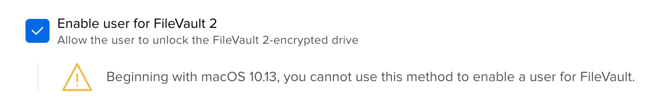

This used to be possible in Jamf...
But ever since we upgraded way past 10.13, we are unable to use this Jamf method.

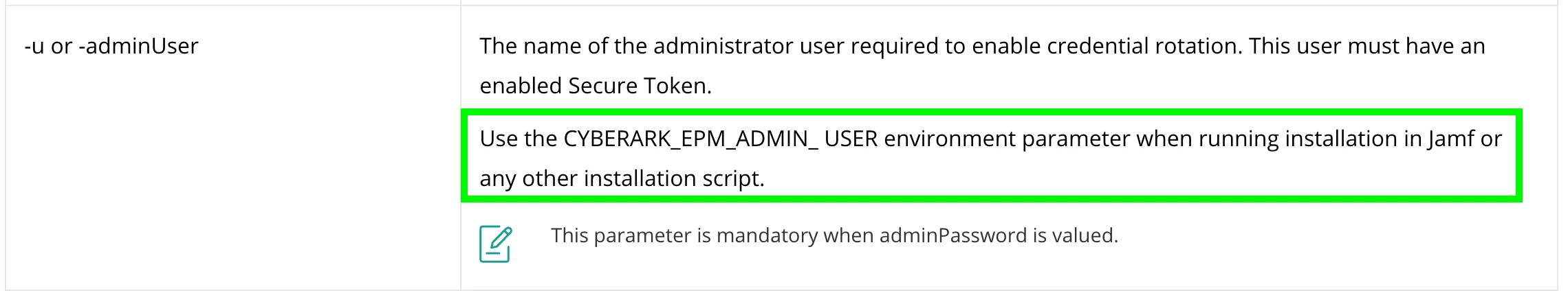

  • December 20, 2022
Is that to handle password rotation? I didn't build the installer for CyberArk for our environment, so I am not that familiar with the need for an admin username / password. I will have to ask my associate.
I also just noticed there's an environment parameter option. Where would I put that within Jamf? This may be the solution to my issue.
