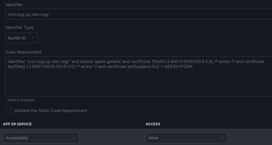

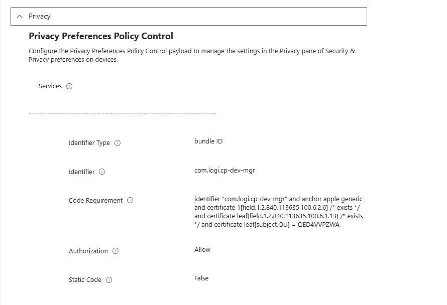

That worked for me … even though we are migrating away from Jamf to Intune, but config is the same
Bundle ID: com.logi.cp-dev-mgr
identifier "com.logi.cp-dev-mgr" and anchor apple generic and certificate 1[field.1.2.840.113635.100.6.2.6] /* exists */ and certificate leaf[field.1.2.840.113635.100.6.1.13] /* exists */ and certificate leaf[subject.OU] = QED4VVPZWA
