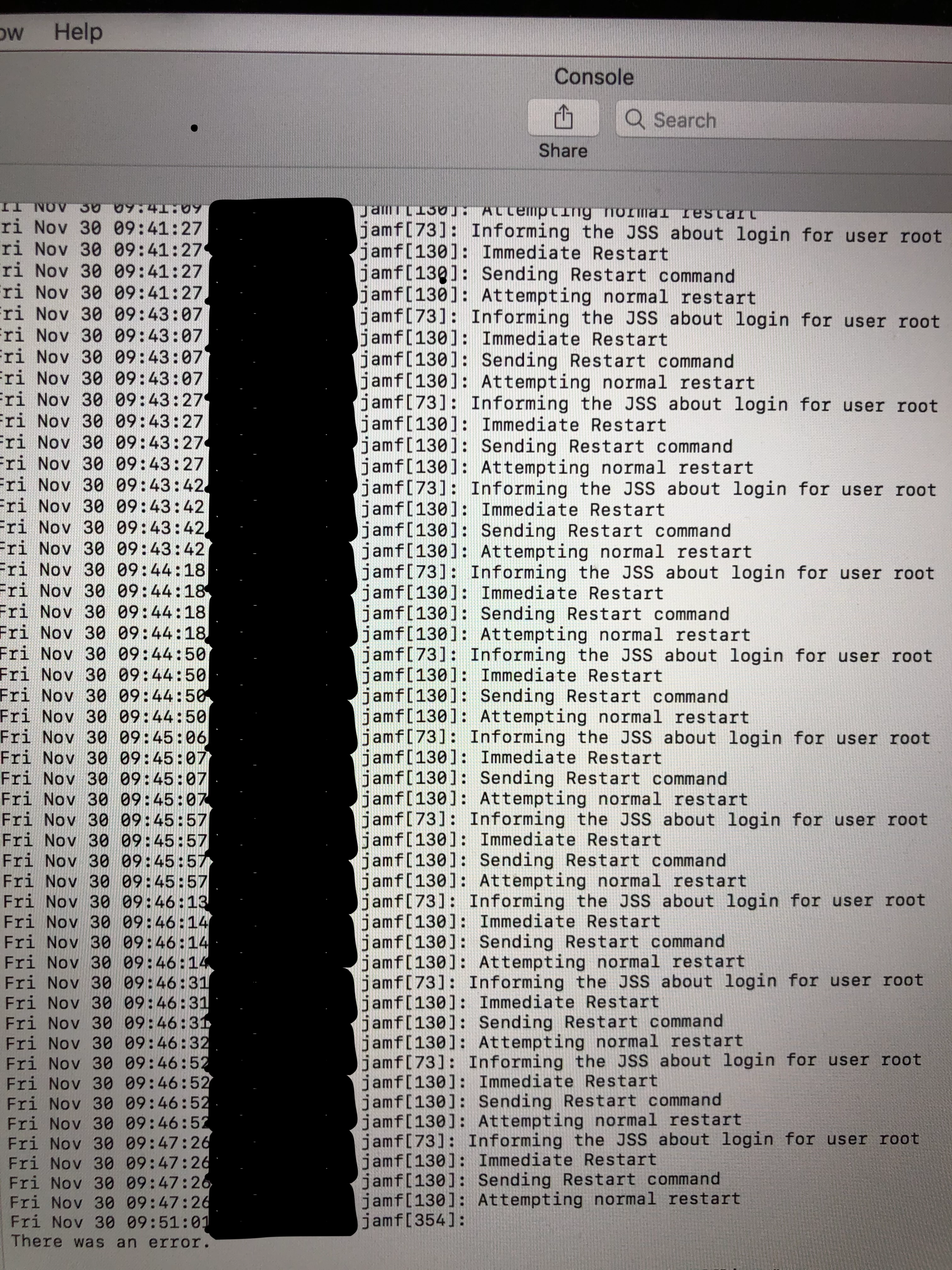

After doing a user initiated enrollment on a non-DEP Mac that is running Sierra it would act like it was starting up by showing the apple logo and the progress bar would get about 3/4 of the way then it would start the entire process over. I was able to get into safe mode and bring up the log at the attached picture is what looks like was causing it. Any suggestions on how to fix?

Do you have a policy scoped to it that would issue a restart, triggered by login? It almost looks like the login for "root" is causing it to run a policy, and then it restarts.

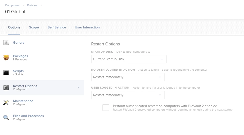

  • November 30, 2018
I attached a picture of the global policy that runs when the device is enrolled. We do want the device to restart once this policy completes but it does look like something here may be causing it?
