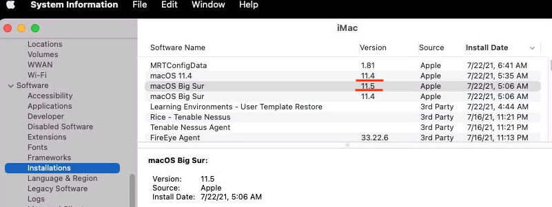

Are MDM update commands in Big Sur unreliable?
I tried sending an MDM command to an 11.4 Big Sur Mac to download update, install and restart but while it seemed to download from the management history, and it even rebooted, nothing occurred (still at 11.4 instead fo 11.5). Nobody was logged into this machine.
Any suggestions?
  • July 22, 2021
They still aren't working well for me; getting very frustrating as I approach the school year and am on the brink of upgrading my Fac/Staff stations.
  • July 22, 2021

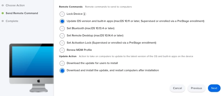

And then you see stuff like this in /var/log/install.log and you just die a little: 2021-07-22 15:55:52-05 CAC301-MD-TS softwareupdated[368]: SoftwareUpdate: request for status for unknown product MSU_UPDATE_20G71_patch_11.5
Jamf Pro recommend using Mass Action Feature which can NOT be scheduled and KILL the network. I tried this on just 25 iMacs and my network was completed flooded and this was at night. It also worked on some and did not work on others. Very inconsistent.
the Policy running softwareupdates -i -a -R says is works in the logs but nothing happens as well. I can't believe the answer is to turn on Apple Automatic Updates or run manually.
    • Log in to Jamf Pro.
    • Click Computers at the top of the page.
    • Click Smart Computer Groups.
    • Select the name of the smart computer group you created.
    • Click View at the bottom of the pane.
    • Click Action at the bottom of the pane.
    • Select Send Remote Commands.
    • Click Next.
    • Under Remote Commands, select Update OS version and built-in apps (v10.11 or later computers enrolled with DEP only).
    • At the bottom of the pane, select one of the following for Update Action:
      • To download the update on computers for users to install themselves, select Download the update for users to install.
      • To download and install the update on computers automatically, select Download and install the update, and restart computers after installation.
