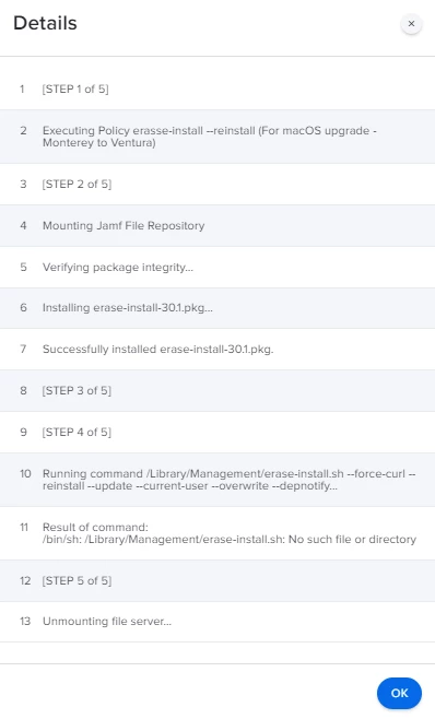

I have created a policy for erase-install with the following Files and Processes command: /Library/Management/erase-install.sh --force-curl --reinstall --update --current-user --overwrite --depnotify
The policy ran successfully on my test machine but it did nothing. I checked the logs in Jamf Pro and it says "Result of command: /bin/sh:/Library/Management/erase-install.sh: No such file or directory"

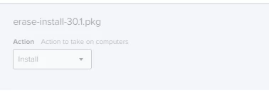

You said that the erase-install 3.0.1.pkg is uploaded, but are you installing it in the policy where you call the command?
  • Aug 17, 2023 2:38 AM UTC
Hi @mickgrant. I thought the package is installed automatically once I set the Action to install.
As per the documentation, it only says to upload the package and then run the script.
Also, here's the log details:

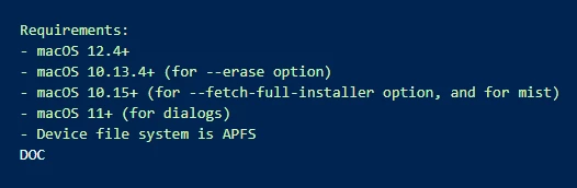

I think I figured out the issue. It's my fault to not check the requirement of the script beforehand.
I just opened up the script and it says that one of the requirements is macOS 12.4 whereas I'm running 12.1.
I will now try with an older version of erase-install.
