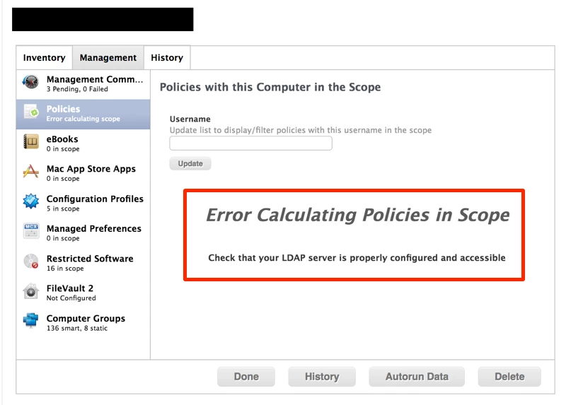

donmontalvo
Forum|alt.badge.img+36
LDAP is working, and "assigned user" is correct.
Anyone know what might cause this error?

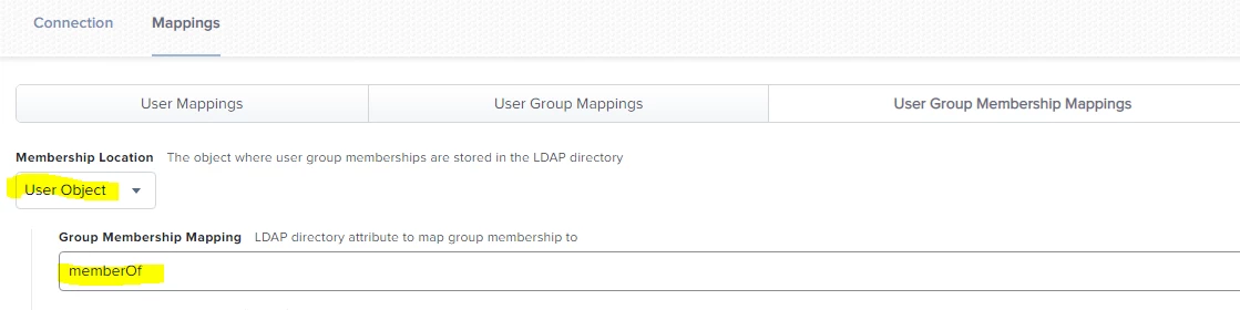

I know this thread is many years on, but hopefully this info will save someone some headache:
We had the same issue, and for us it was a matter of getting the group membership information pulling from the right place and ensuring that our LDAP search base(s) weren't too narrow to find the correct information.
We ended up switching the Membership Location field to pull group membership data from the "memberOf" field of the User Object, rather than the "member" field of the Group Object.

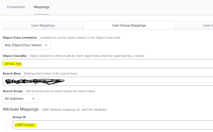

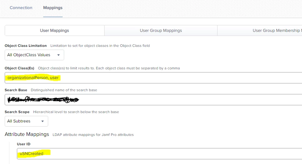

Hi @Portuguez, i have the same Problem, did you find Solution for it?
What solved it for us was adding the highlighted sections:
Prior to 10.33 is was working with different settings, but post 10.33 we changed the settings after working with JAMF Support.  One issue was that we do not have just one all encompassing user group in our AD.
  • November 17, 2021
Please click on the image in my previous post as their are 3 images.
  • November 17, 2021
This contributed to solving my issue as well.
  • November 17, 2021
@Portuguez  @grahamsdgr  it worked. thank u  guys!

This thread solved a similar issue for us too!  We had this error under Config Profiles though, not Policies. The one addition I can make:
We are using JumpCloud for LDAP. When switching User Group Membership Mappings from Group Object - member to User Object - memberOf I also had to check the box to use distinguished names of user groups.
