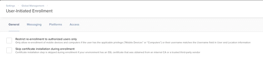

I came across this today for DEP Devices.
After speaking with JAMF if you disable the the following. It resolved the issue in our scenario
Settings > Global Management > User-Initiated Enrollment > General > Restrict re-enrollment to authorized users only
Disable the the following - As Per Screen shot
