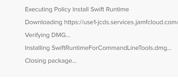

I'm rolling out OneLogin Desktop in a couple of weeks and to successfully deploy to any pre-10.14.4 machine I need to push out Swift Runtime for CLT. I did this yesterday, but I would love to see if the policy failed on any machines. Not sure how to make a Smart Group for this since Swift for CLT isn't an "app," per se. Any suggestions?

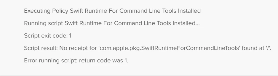

No luck. I checked my work against some of the laptops in the INSTALLED group by running:
pkgutil --info com.apple.pkg.SwiftRuntimeForCommandLineTools
...silently in the background. While I assumed I had a successful install earlier, it clearly did not install. Don't know how I got my Extension Attribute / Smart Group wrong.

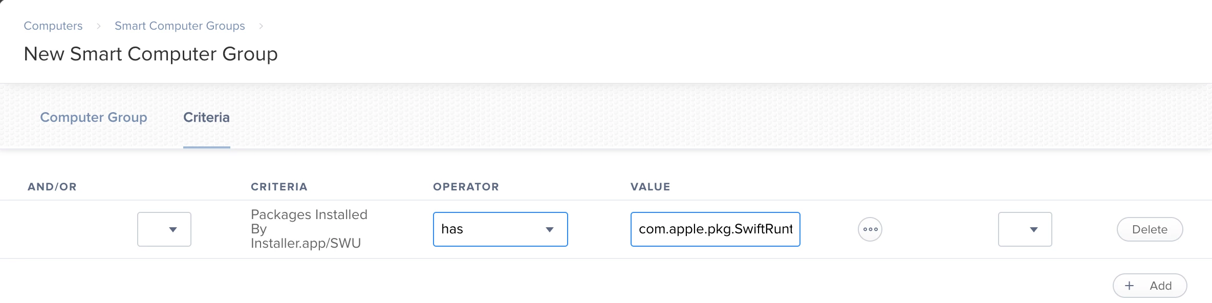

  • November 5, 2019
Can you use the "Packages Installed By Installer.app/SWU" for this?
Just updated the Smart Group and my one known computer populated. I'll push the install out again and give it some time to run to see if the Smart Groups update. Thanks! I had no idea that was even in option there!
Got it. You're a genius.
