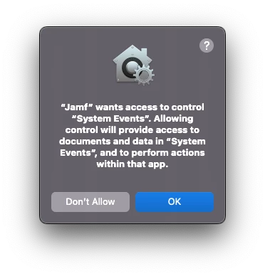

Ironically, I was looking at that script myself today trying to update my old auth scripts. I got that same error, I suspect there might be another xml file in tmp with that name (since it's just a number). I updated my code to "/tmp/$Jamf_EA_{EA_ID}.xml" in a few spots and it seems to be working now (although I'm getting a HTTP 401 return code trying to get the token). Slow progress is still progress, right?
Edit:
My credentials were setup like this:
encodedCredentials=$(echo "$APIUSER:$APIPASS\\c" | base64)
This worked fine when I ran the script locally, but failed when running through my Self Service policy. When I swapped in the `printf` command above, I got the prompt below and clicking that worked.
