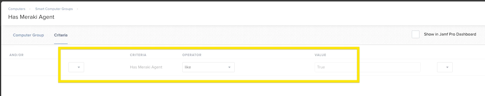

Hi,
I'm trying to report on which of out machines don't have Meraki Agent installed. I have created Extension Attribute and used a Smart Group but its not showing any machines as having Meraki Agent.
What am I doing wrong?

Best answer by mschroder
Hm, that is an interesting case. Seems when I pipe something to grep the exit code is not what 'man grep' promises - I always get '0'.
But why do do you need a EA for this? The MDM already knows which Profiles are installed. So just base your smart group on the criteria 'Profile Identifier' 'is' 'com.meraki.sm.mdm'.

  • February 12, 2020
@mcgace Have you tried to comment out the exit lines, especially the exit 1?
As you said it works in Terminal but JSS may get that exit 1 as a failure and not send the info upstream (not sure as I always end my EAs scripts with exit 0).

  • February 12, 2020
Thanks guys, all valid responses and they do work as solutions. @mschroder was right, I am making extra work for no reason, so I based Smart Group on Profile Identifier
