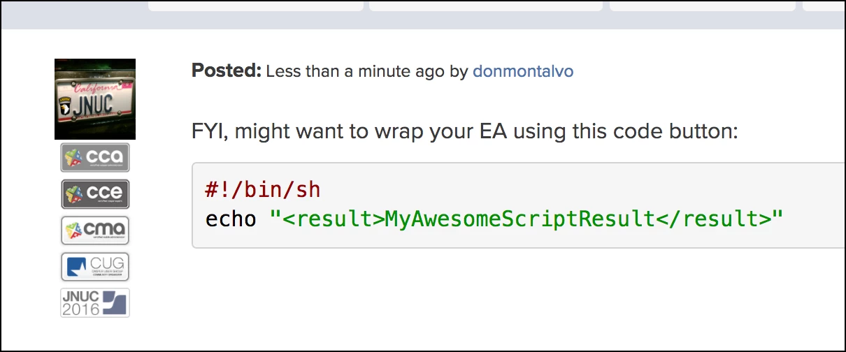

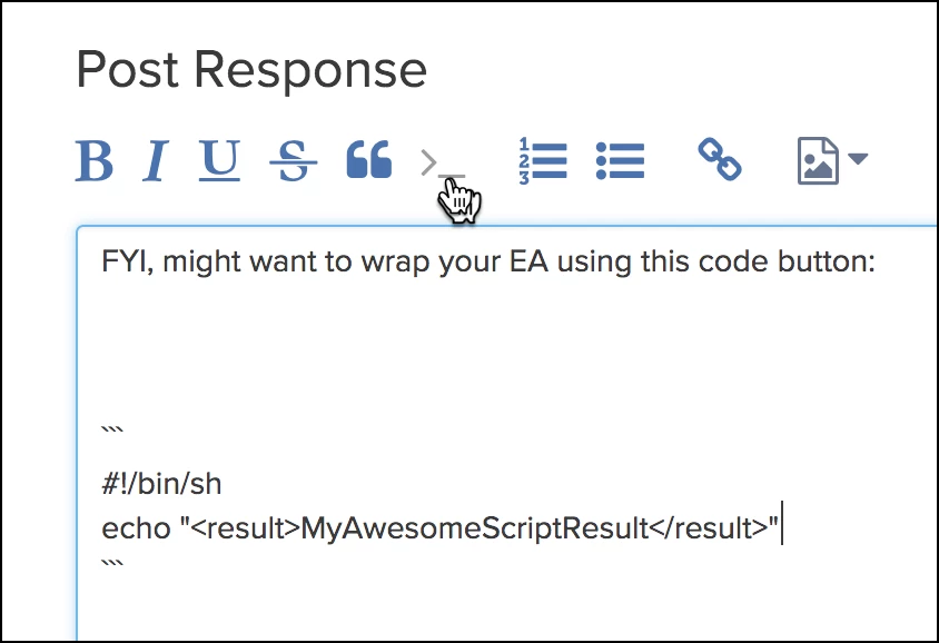

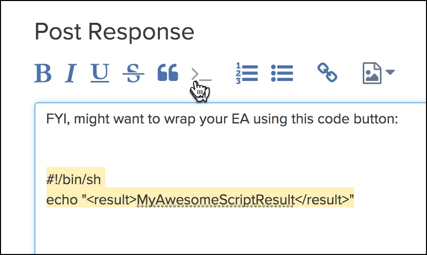

FYI, might want to wrap your EA using this code button:
echo "<result>MyAwesomeScriptResult</result>"
