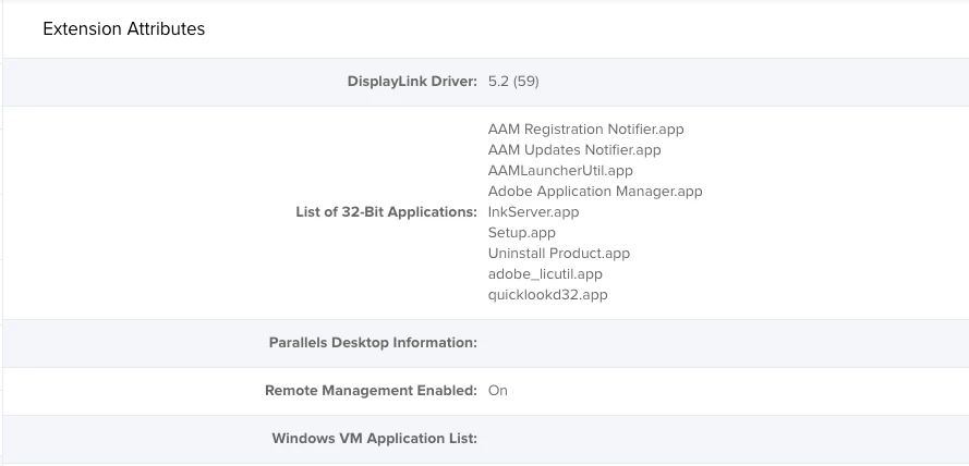

Thank you all for reviving this thing, You all are rockstars!! I just want to start by saying I am not a HUGE fan of Parallels at all and would love to be on Fusion but the powers that be, went with Parallels. All I truly want to do is put in a EA that there is a VM and Grab all he installed applications on that VM.
Is that possible to do with EA?
