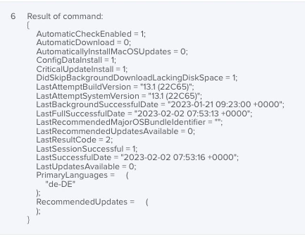

@JevermannNG That is really weird. What is the result if you run the following command on one of the Macs reporting Unknown (run it via a Policy using the Execute Command option in the Files and Processes payload)?
/usr/bin/defaults read "/Library/Preferences/com.apple.SoftwareUpdate.plist"
@sdagleythat works and the result looks like this:
Changing the EA to a Policy with Script option works. I get the correct output on a Mac with the Configuration Profile and on a Mac without the Profile:

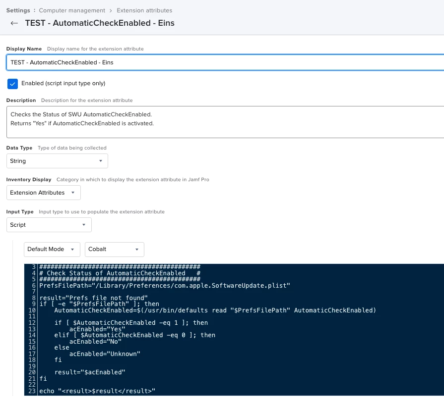

@JevermannNG So we know the prefs info is available but not why the script isn't returning the right info when run as an EA. Can you post an image of your EA configuration screen for it?
Hi @sdagley here it comes and thanks for the support!
@JevermannNG Nothing looks odd there. Do you have any other EAs running? I'm wondering if you might have another EA that's somehow preventing completion of data collection. Could you try adding an EA to run the following script just to see if it returns anything:
