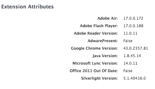

We've recently become much more proactive in pushing updates to our users' machines. One thing we've set up is a handful of extension attributes that report back the installed version of the various programs. Most machines are reporting back flawlessly. Here's what one of those machines looks like:

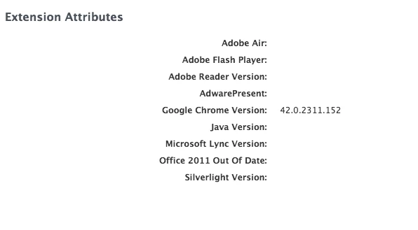

When I came in this morning, I found that one machine had run the policy 40 times over night. It wasn't the only one to run it multiple times. I went into the extension attributes on it and found something very odd.
This machine had been checking in just fine, but it wasn't actually updating the extension attributes. Others are updating some, but not all of them. I did a search for "Adobe Flash Player is "(blank value) and found that roughly 18% of our machines were not updating that field. I haven't checked the rest yet, but I'm guessing it's about the same.

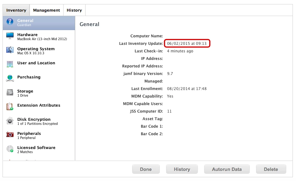

Just to confirm, do you mean the EAs aren't up to date but an inventory has successfully completed like in this screenshot.
As a test, I would un-enroll and re-enroll one of them and see if it updates.
  • June 8, 2015
Yes, that's what I'm meaning. Inventory will complete without errors but fields do not fill in. The machine I took the screenshot of actually completed inventory each of those 40 times.
