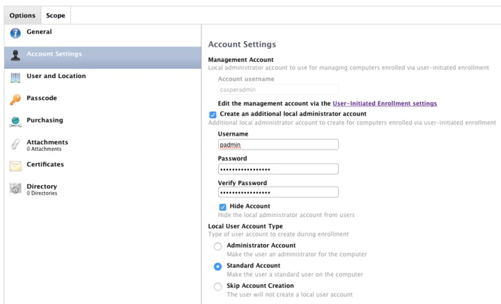

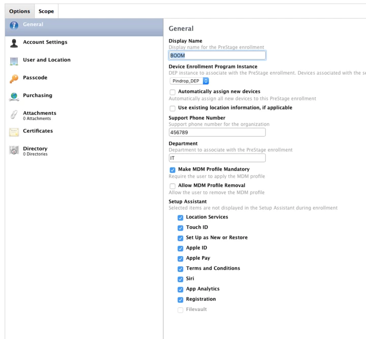

I will attach our PreStage settings
When we run through the Setup Assistant DEP will kick in and say "We are going to config your computer." It will wait there for a couple mins and then error our saying:
“Failed to contact Mobile Device Management server"
If we then go into the JSS we will see the SN's in the inventory but not managed. This is a hosted JSS.

Also. If we turn off DEP, finish the setup assistant, then turn DEP back on we will get the warning saying "hey, this is part of DEP blah blah" We can finish the enrollment there with no problems.
It must have something to do with the prestage that is jacked up but am out of idea's.

We have narrow it down the the account creation. If I remove the "Account Settings" and don't try to create local user everything works fine. If I do anything within "Account Settings" thats when it will fail on us.

I've been told by JAMF that in order to use the Account Settings payload you also need to have the Directory payload configured. While it is not called out anywhere if you only configure the Account Settings the entire prestage will fail.
