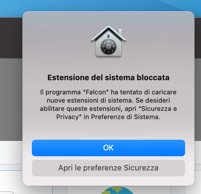

Hi all,
I'm actually using this config profile for pushing system/kernel approval and PPPC control.
Everything looks to be working except for the "System extension approval", it keeps asking for the approval.
It is actually working in macOS Catalina, but I'm not that lucky for macOS bigSur. Any advice?

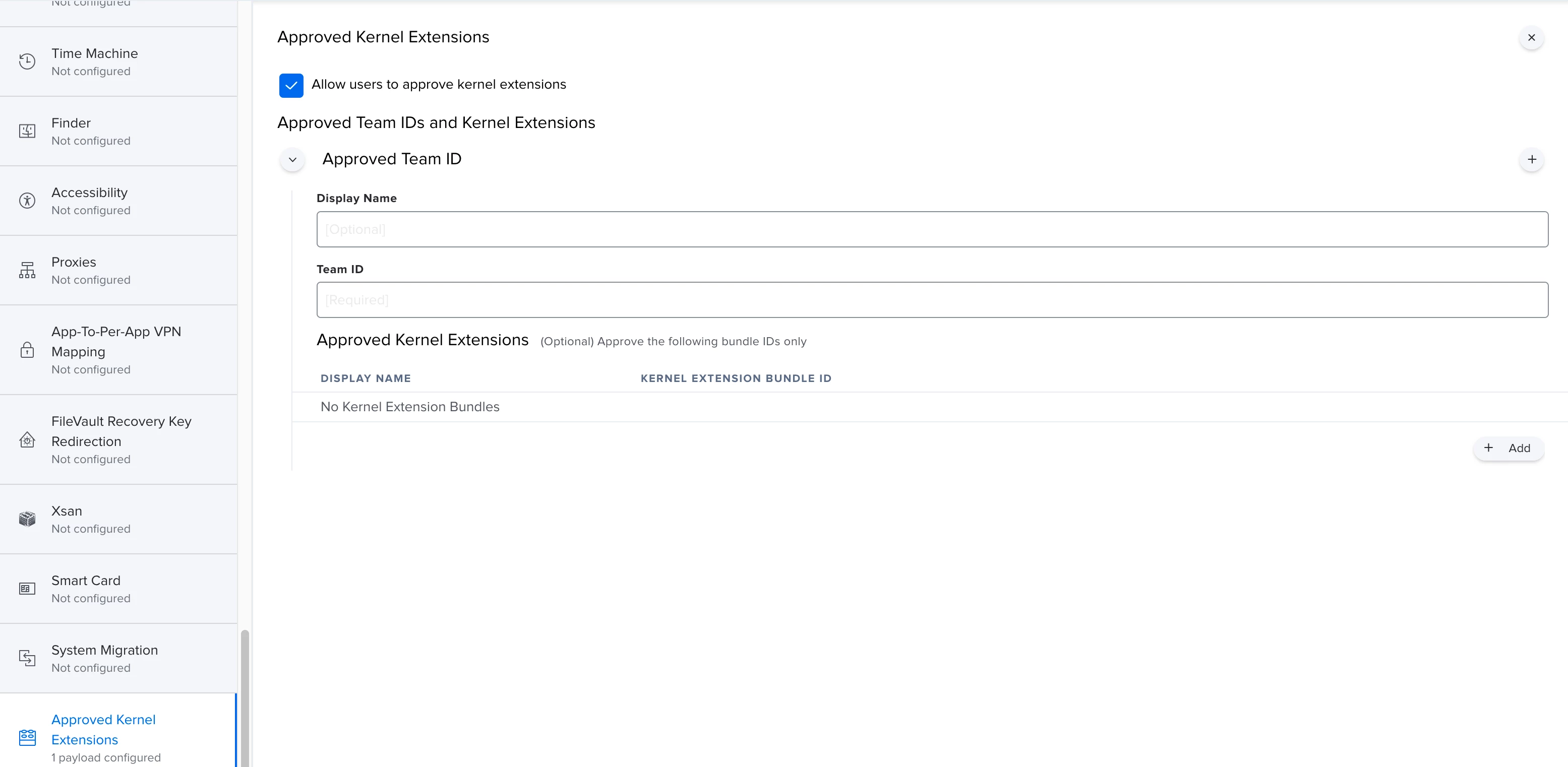

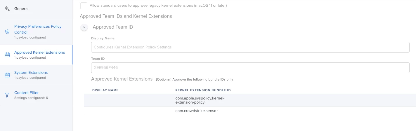

Hi @alessio.tedesco The message is about System Extensions but you showed the Kernel Extension section in the Jamf Pro setup of a Configuration Profile
Scroll down to the end in the sidebar and you will find System Extensions

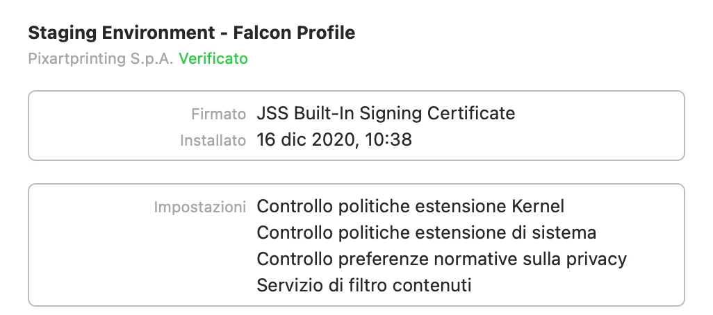

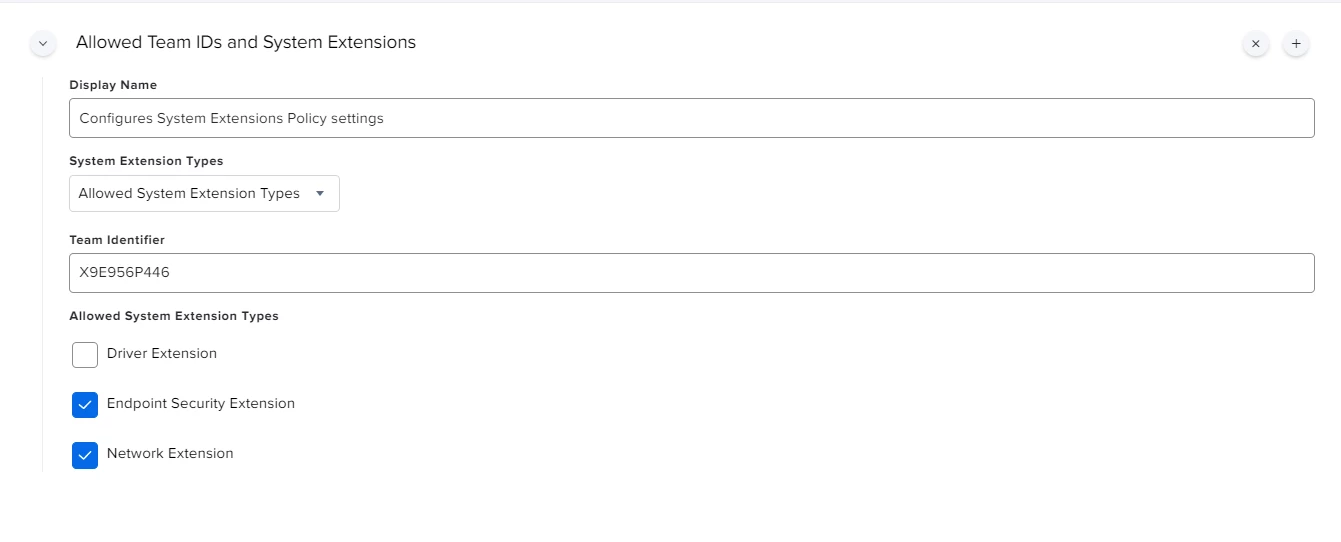

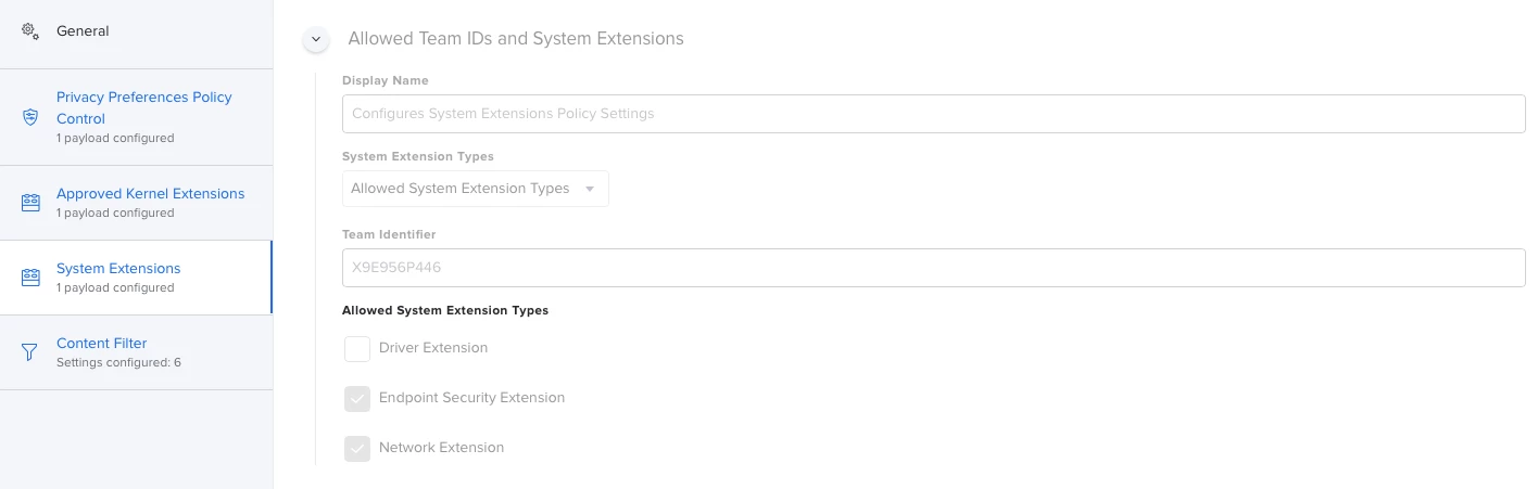

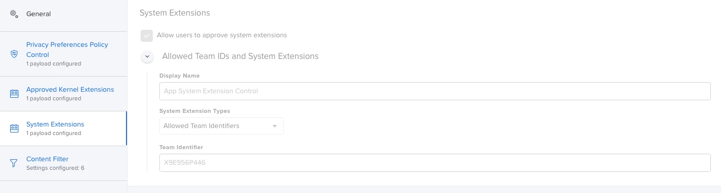

Hi @dlondon ,
I'm sorry, attached the correct screenshot.
  • December 16, 2020
@alessio.tedesco You are missing some System Extension options in your profile. Having said that, I don't have an answer for you but I'm actively working with both CrowdStrike and Jamf support right now. When I know more I'll post to the following thread.

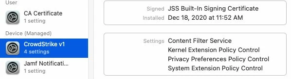

@alessio.tedesco Glad you got it working. I'd love to see some screenshots if possible cause no matter what I've tried I can't get it to work.
Also couldn't hurt seeing what the profile looks like on a client in System Preferences > Policies as well.
Thanks.

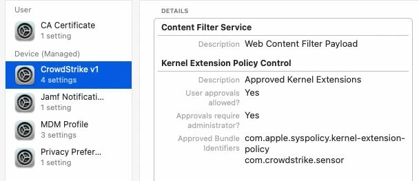

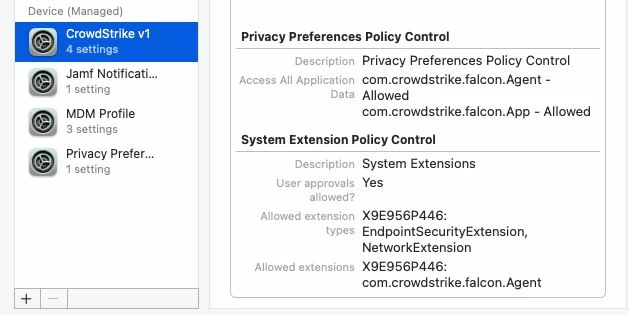

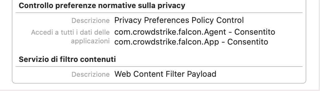

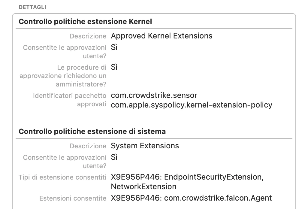

Sure @ubcoit ,
there you go!
This has been deployed through a configuration profile, kindly let me know if you need the text to be pasted here in a comment :)
Attached all the screenshots of the policy:
Attaching how the policy looks like in System Preferences:

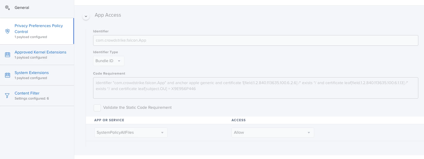

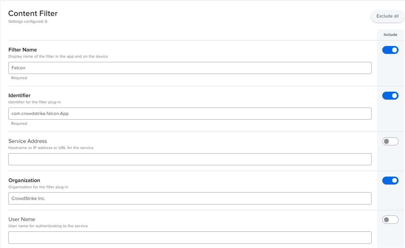

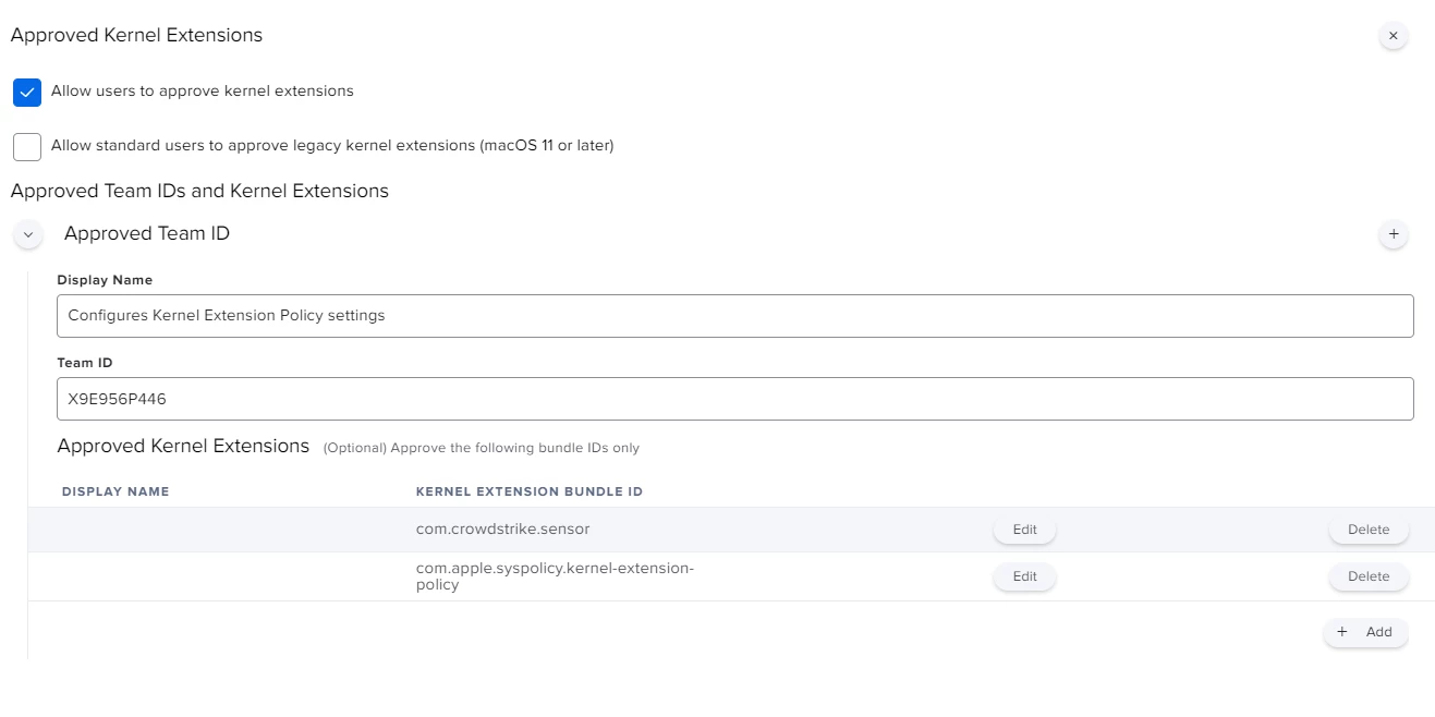

  • December 19, 2020

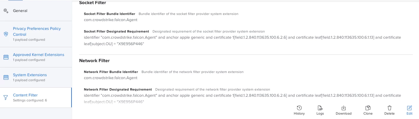

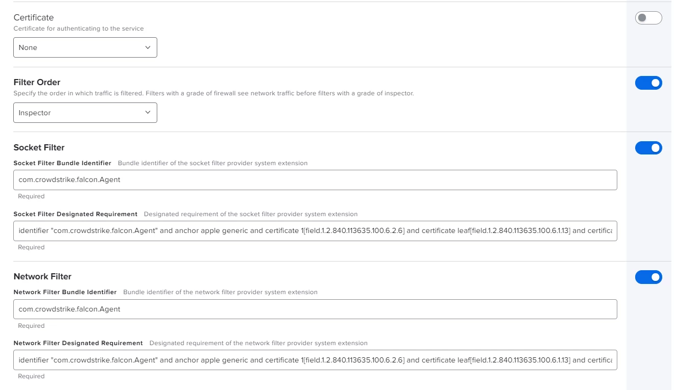

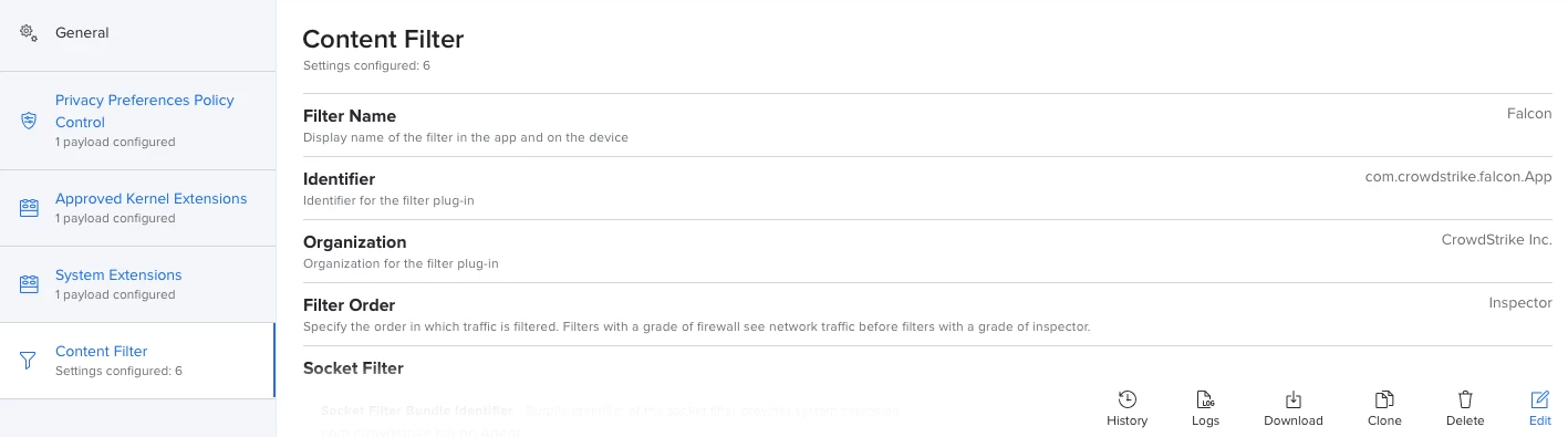

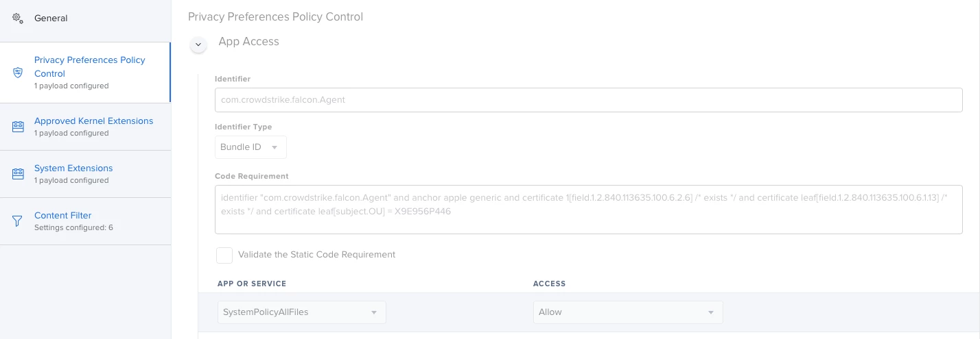

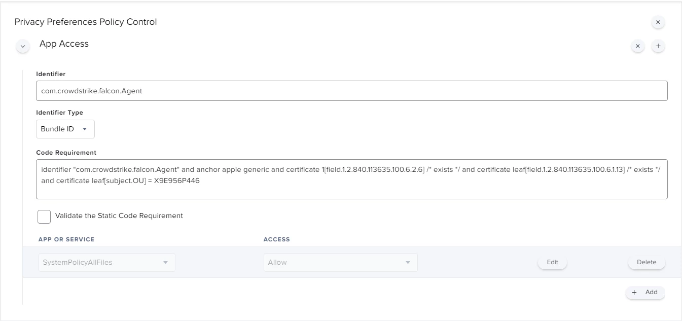

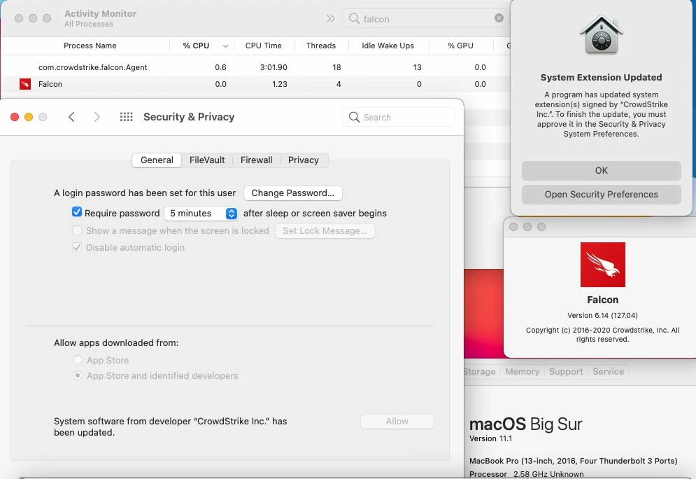

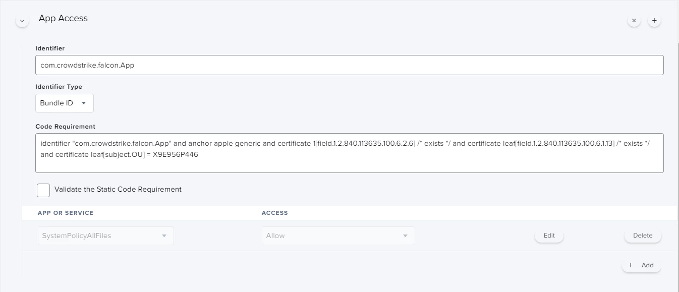

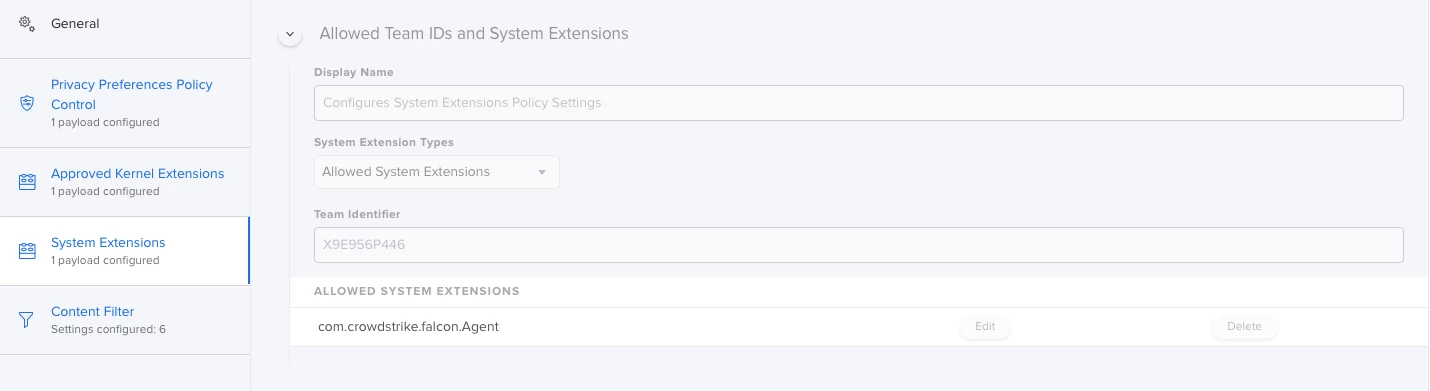

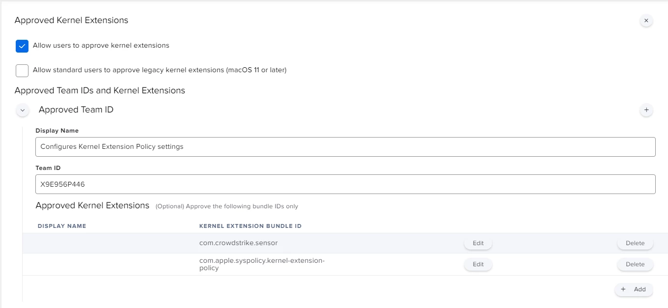

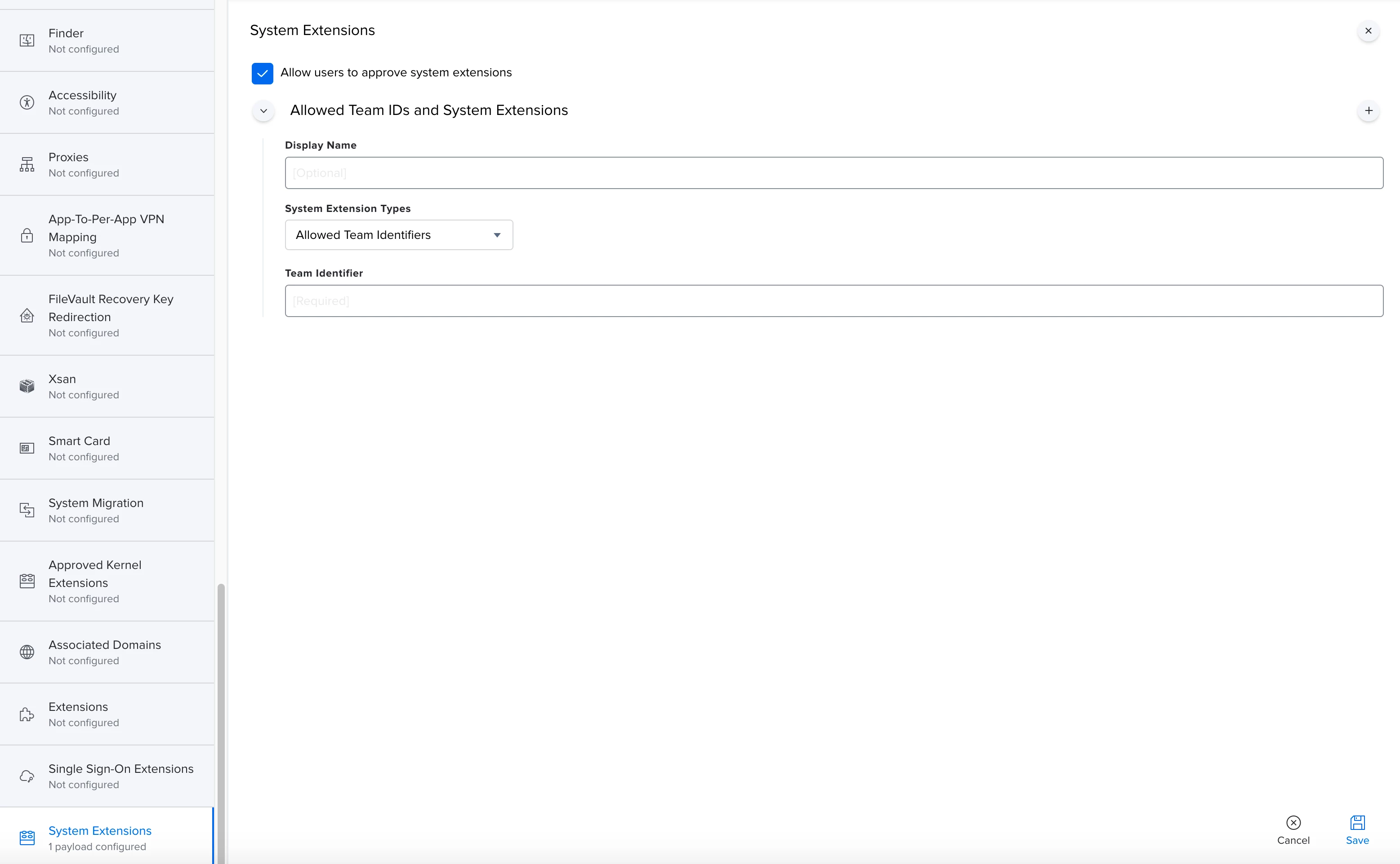

Thanks @alessio.tedesco Still no dice for me. I mirrored your settings, I believe, and other than some of the order of things which I can't seem to control, I don't think I missed anything. End result, CS is running but I get the update prompt in my last photo.
PPPC
Kernel Extensions
System Extensions
Content Filters
Client Profiles Pane in System Preferences
Prompt and other information

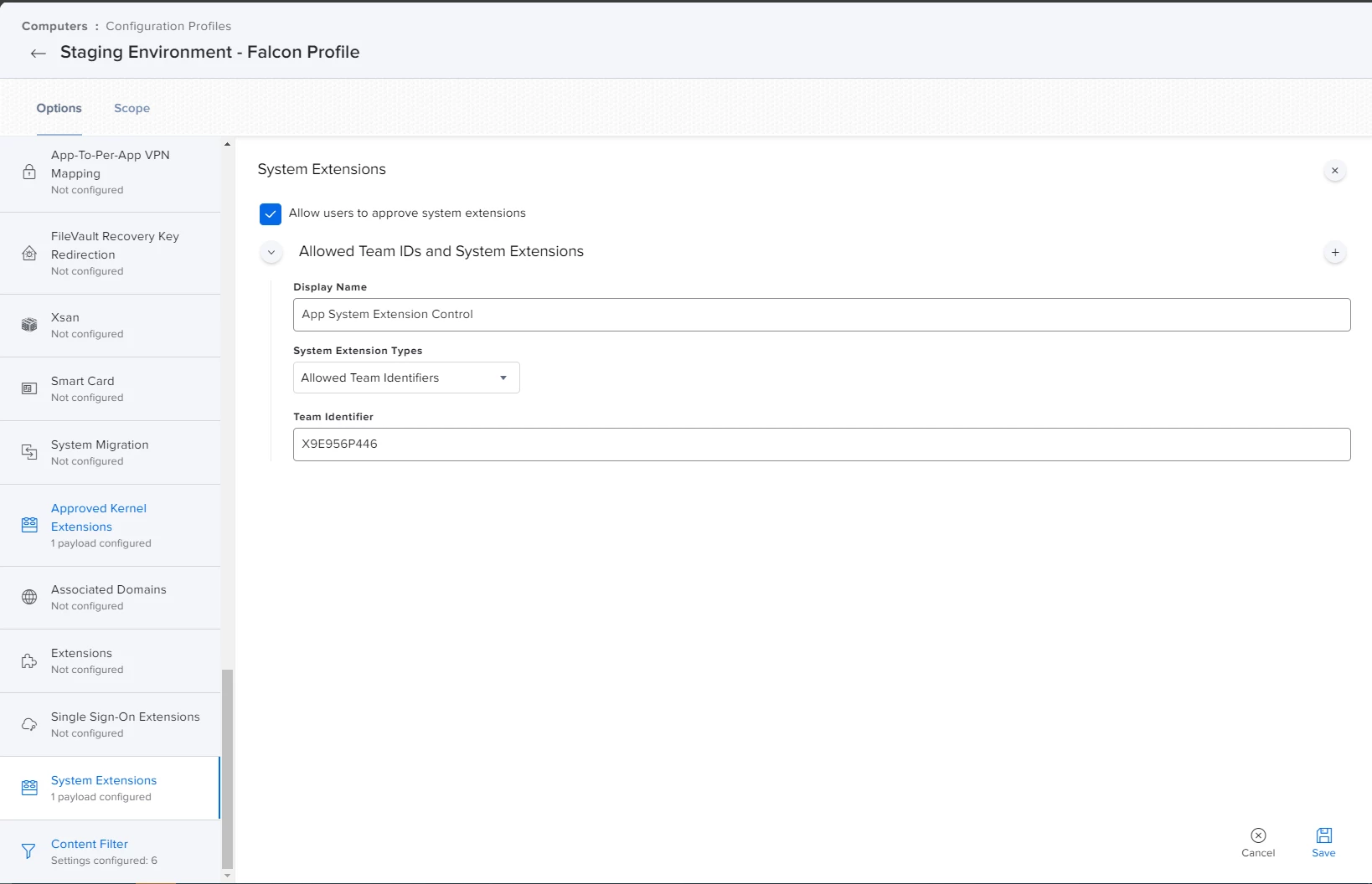

  • December 20, 2020

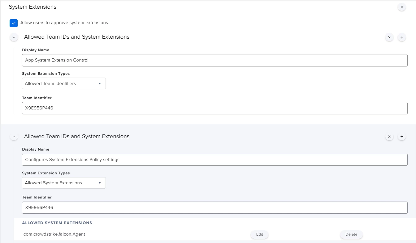

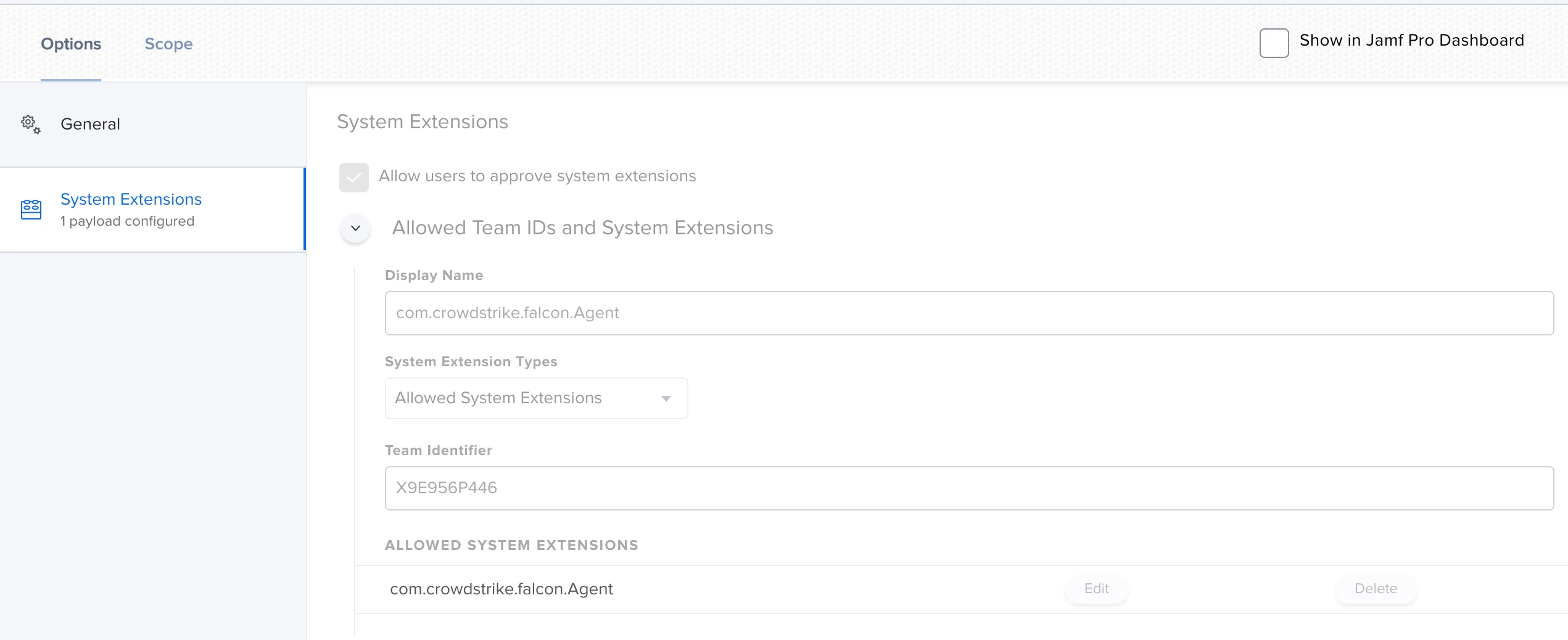

So i've been doing a lot of work with version 6.14. First thing ... split up your profiles! Make the PPPC it's own, the KEXT it's own, the SysExt it's own and so on... Trust me, your Apple Silicon macs will eventually thank you. I've attached how the System Extension payload should look.

I believe you need to further modify the provided .mobileconfig.
The last two sections don't have the bundle id string defined and instead show "StaticCode" and you need to add X9E956P446 so they look like this:
<string>bundleID</string>
<key>X9E956P446</key>
Worked on Catalina as of this week.

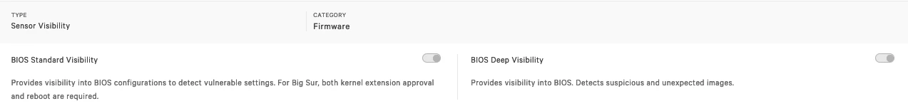

I have an answer for those like me who got here with a Google search. If you have the "System Extension Updated/Blocked" window (first it's a lie, it's a legacy kernel extension), it's because the BIOS Standard Visiblity is enabled on a Falcon policy. This will not only show up at the sensor installation (on Big Sur and above), but at every sensor update going forward. Note that whatever the end user does, Falcon is still running and working. It just won’t gather firmware data until the kext is approved and the computer rebooted.
The popup won't show up on M1 computers because this firmware analysis feature doesn't seem to exist.
  • February 7, 2022
