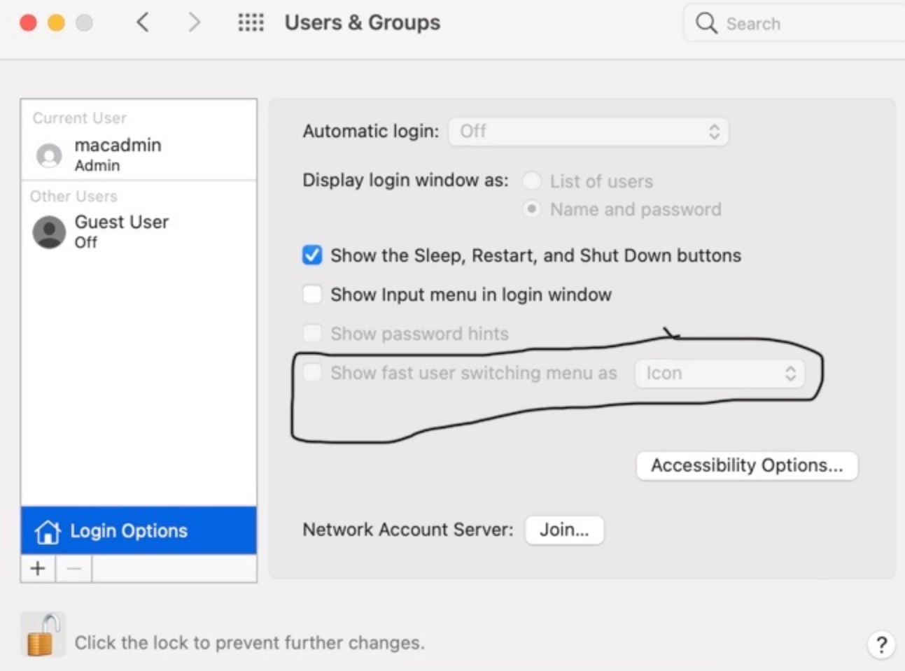

Can someone see if they can manipulate this setting in jamf? I don’t see a restriction for this one and it’s blocked on my workstations for Big Sur only. Which is odd because its unlocked on the catalina workstations

Even if you don't see a restriction, I would do a process of elimination and exclude the Mac from the config profile in Jamf to see which config profile may be restricting fast user switching.
  • December 3, 2021
Try this in Terminal:
sudo defaults write /Library/Preferences/.GlobalPreferences MultipleSessionEnabled -bool YES
then you will get 'Show fast user switching manu as' check marked and option would be enabled for selection.
  • December 3, 2021
Fast User Switching can be turned off or on using the Login Window payload. Check your profiles for one that contains that payload.

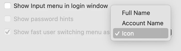

Hi
I ran that command but no luck :(. Closed and re-opened sys prefs and its still greyed out.
  • December 3, 2021
What is my observation, I did try this command on my 4 Macs ( 2 M1 and 2 Intel) those are having Monterey. when execute
defaults read /Library/Preferences/.GlobalPreferences MultipleSessionEnabled
output is one, means its enable but that option would be highlight for manual selection.
you would see only the box is check marked, If
that's not happen then create a new users and see this happens immediately as I observed on two Macs.
