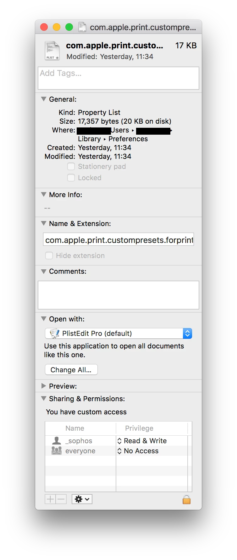

We have a very similar issue. We too have AD accounts with spaces and FEU has decided to set permissions randomly to local accounts that don't have a space in the name.
For example, sometimes files deployed by FEU get assigned permissions as _sophos (the Sophos Central Endpoint account) and sometimes they get assigned permissions as the local administrator account which doesn't have a space in the name.
It is fine to argue that having spaces in usernames is bad practice, it's another when JAMF arbitrarily assigns permissions to files from other local accounts. That seems like a security risk to me and should be addressed as a bug.
