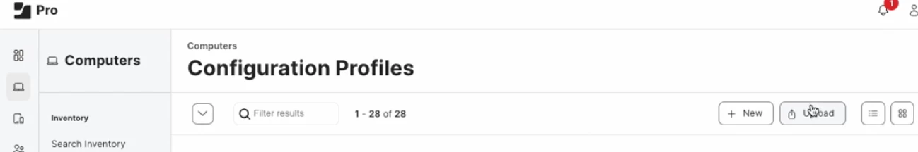

Hello,
I am trying to create a configuration profile on Jamf to deploy it to my mac laptop.
The .mobileconfig is built using the template mentioned here (docker.mobileconfig): https://docs.docker.com/enterprise/security/enforce-sign-in/methods/#macos-configuration-profiles-method-recommended
When I try to upload this in Jamf (we use Jamf Pro) using the “Upload” option shown below, it fails with the error “File Cannot be processed”
I am able to create the profile using the “New” button where I copy and paste my profile in the Property List box.
I don’t suspect anything wrong with the template structure as using “New” button I am able to upload it and also I am  able to directly add my profile on my mac laptop.
Any idea why I am getting “File Cannot be processed” error when I use “Upload” option ?
I have reviewed few old posts reporting similar error, but they are slightly different than my issue.
Appreciate any help.

An update on this. It was indeed an inadvertent space in the .mobileconfig file. There was an extra white space on the first line at the beginning
 <?xml version
Once removed everything worked fine. plutil didn’t complain about the white space. Not sure why JamF couldn’t handle it. If anyone from JamF is here, appreciate if the user facing error reporting can be improved.
